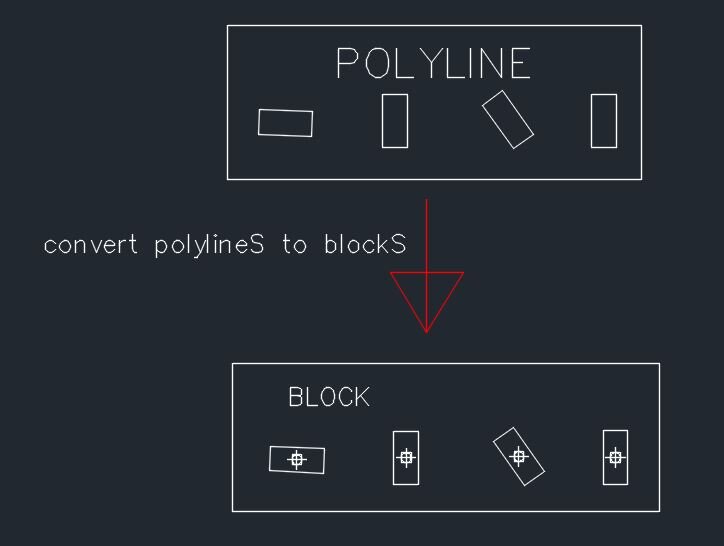

hosneyalaa Posted December 17, 2020 Share Posted December 17, 2020 (edited) Hi all please help I have multiple POLYLINES that are the same I want to convert it into a block with the same name Thanks in advance RECCDrawing4.dwg Edited December 17, 2020 by hosneyalaa Quote Link to comment Share on other sites More sharing options...

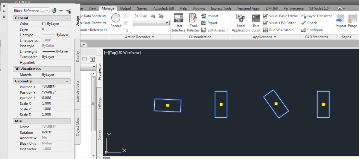

hosneyalaa Posted December 17, 2020 Author Share Posted December 17, 2020 5 minutes ago, Trudy said: Easier way is to select them and copy with base point and paste as block. I want every POLYLINE AS block All blocks have the same name Until If you change any block for example, add a point It applies to all Quote Link to comment Share on other sites More sharing options...

hosneyalaa Posted December 19, 2020 Author Share Posted December 19, 2020 @BIGAL , marko_ribar , mhupp , Trudy Thanks to all Please take a look at the code Is it good I hope you improve if possible (defun C:testP2B (/ ss base n blk pl ANG ANG0 AUNITSS MIDPT MIDPT0 PL0) (SETQ AUNITSS (GETVAR "AUNITS")) (SETVAR "AUNITS" 3) (if (setq ss (ssget '((0 . "*POLYLINE")))) (progn ; then (setq pl0 (ssname ss 0)) (setq midpt0 (vlax-curve-getStartPoint pl0)) (setq ang0 (angle '(0 0 0) (vlax-curve-getFirstDeriv pl0 0 ); end 1st deriv ); end angle & ang ) (if (not (tblsearch "block" "P2B")) (command "_.block" "P2B" "_none" midpt0 pl0 "" "_.insert" "P2B" "_none" "@" "" "" (rtos ang0 2 3) ) ) (setq n 0) (repeat (- (sslength ss) 1) (setq n (+ 1 n)) (setq pl (ssname ss n)) (setq midpt (vlax-curve-getStartPoint pl)) (setq ang (angle '(0 0 0) (vlax-curve-getFirstDeriv pl 0 ); end 1st deriv ); end angle & ang ) (command "_.insert" "P2B" midpt 1 1 (rtos (- ang ang0) 2 3)) ); repeat ); progn ); if (SETVAR "AUNITS" aunitss) ); defun Quote Link to comment Share on other sites More sharing options...
