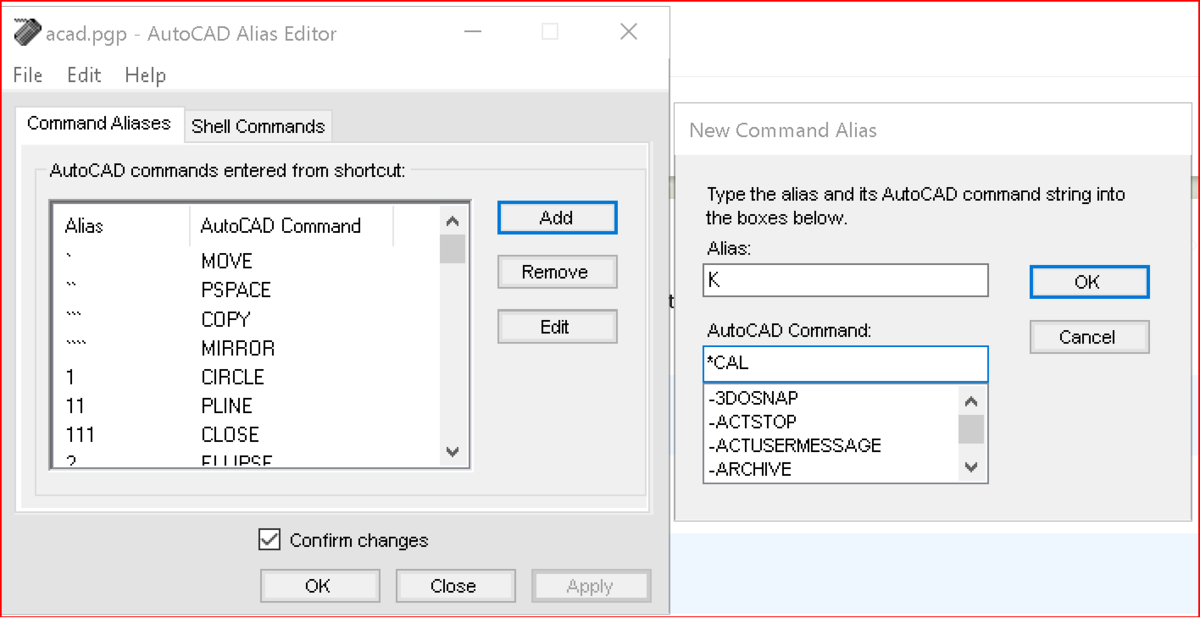

sadefa Posted December 16, 2020 Posted December 16, 2020 Hello to all. Some of you might know that whenever you might use an expression to determine the input value. For example you want a line with length of 20 you can always run command “line” and when prompted for the length write ‘cal and then 10*2. This will give line length of 20 units. What I am looking for is a way to change the ‘cal command as it’s too long for me to type it each time. Any ideas how to achieve this? Quote

steven-g Posted December 17, 2020 Posted December 17, 2020 (edited) You can add a command alias to your pgp file so you only need type an apostrophe folowed by a single keyboard letter, so at the end of the pgp file add this (I just picked 'K' because 'C' is used so often for other things. K, *CAL So when you want to use the CAL command transparently you only need type 'K unfortunately you cannot add K, *'CAL as an alias the apostrophy isn't accepted as a valid entry, but using something like 'K still saves 50% of your keypresses. You do need to run the REINIT command after you save the pgp file to make changes to your pgp file available to use. Or you could create a new command in the CUI 'CAL and run it from an icon in your ribbon or a toolpalette with a single mouse click (but that might not be any quicker if you have to move the mouse to an icon everytime you need it. Edited December 17, 2020 by steven-g 1 Quote
Dadgad Posted December 17, 2020 Posted December 17, 2020 (edited) If you are inclined to go with steven-g's suggestion, try using the aliasedit command to access your PGP file easily on the fly. As shown in this screenshot. Done this way you won't need to run the REINIT command, but DO make sure you click the confirmation OK buttons as you click out of each dialog box. Edited December 18, 2020 by Dadgad Trying to delete multiple insertions. Quote
