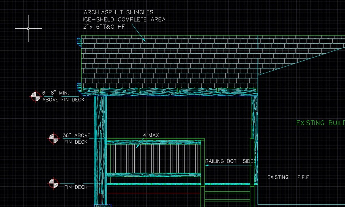

What I need to be able to do, is make PDF's that printout with different line weights.
i blueprint printed out have have different lines weights.
I know I have to set up PEN weights but I just can make it work.
Raymond

Ray here is what I did in AutoCAD so maybe there is a way to duplicate in Microstation;

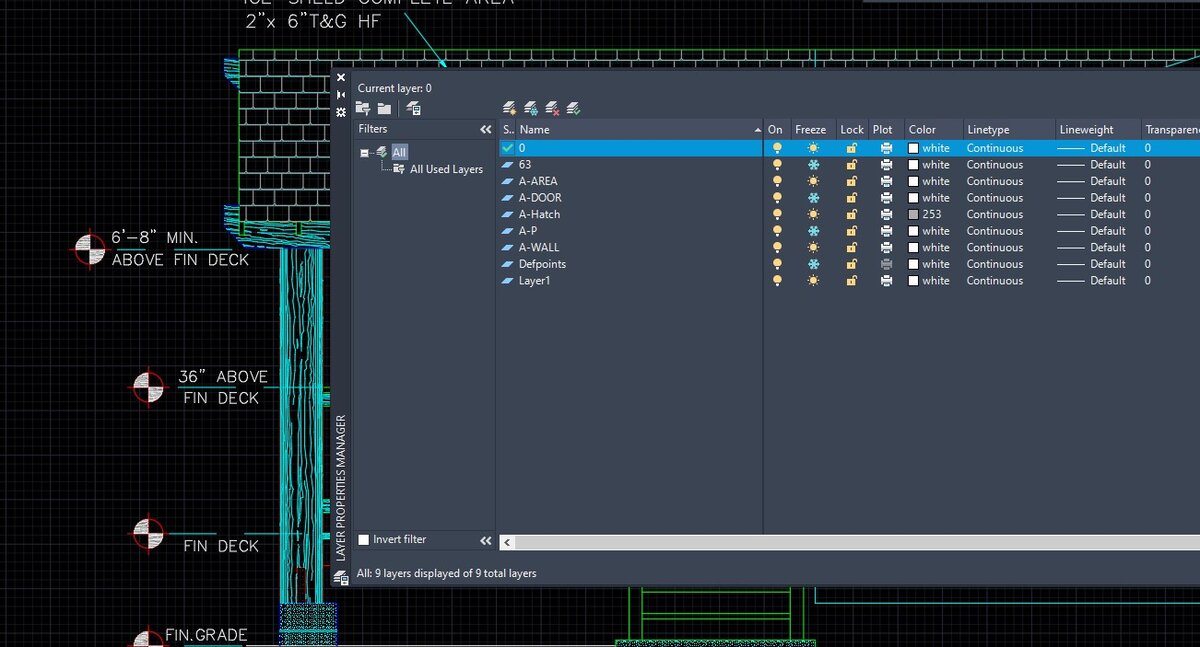

When I opened up your drawing I saw that most of what I would consider "bold lines" were colored Blue, Green and Red.
While the drawing had layers (levels in microstation?) these were all set to white so I couldn't set a width by color there.

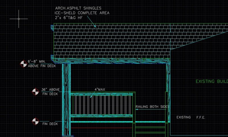

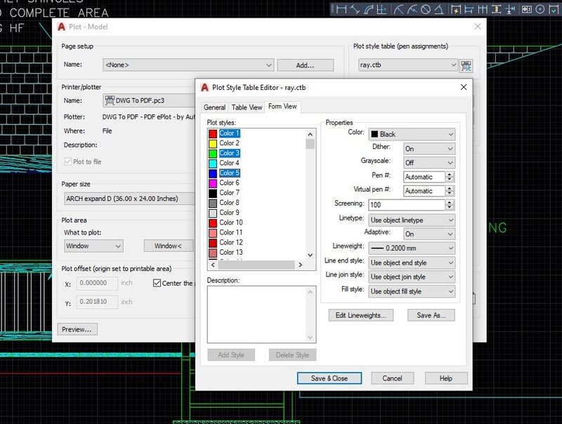

So went into my plot settings and set up a Plot Style Table to print all colors at .05mm and Red, Green and Blue to print at .2mm.
I printed to a PDF this way and got the desired look that I think you where after.
