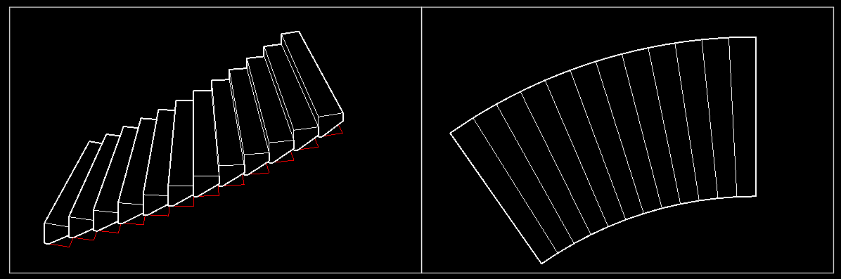

Bill Tillman Posted December 3, 2020 Posted December 3, 2020 (edited) I was giving this one a try and it turns out to have some tricks in its geometry. It's going to be cast from concrete and this is what I created thus far. Basically, I drew the inside and outside radii and then started adding risers and connecting points. Once I had that I drew the shape of each end of a tread. Then I lofted between them and copied and aligned the results multiple times for each tread elevation. With my minimal understanding with LOFT this is probably a very crude way of doing it so I thought I'd check if anyone has a better method for constructing this set of stairs. BTW, it does get more complex with a landing on the same radius and then another set of 12 steps before it terminates at the upper floor landing. Drawing1.dwg Edited December 3, 2020 by Bill Tillman Quote
Berzerker Posted December 3, 2020 Posted December 3, 2020 Being a rookie at AutoCad I think I would have made a solid of the first stair (step) then just copied and pasted them at the right position and elevation (7" X 11") I believe it is. What are you lofting? I looked at your drawing, great Idea. I might have even created the whole staircase out of a solid and just subtracted the steps from it " Seeimgs how it's being poured out of concrete. Concrete aint cheap You can't hide "MONEY". Quote

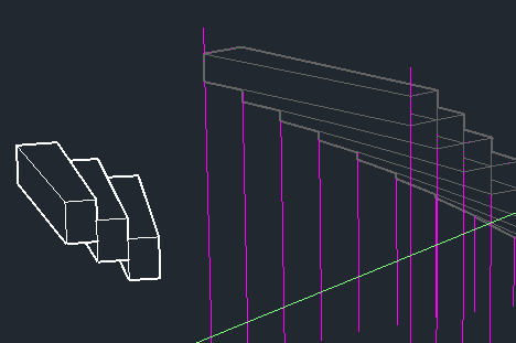

BIGAL Posted December 3, 2020 Posted December 3, 2020 (edited) You should be able to take what I showed as an example for the concrete shape just make yours deeper then should be able to union. Even if ends are square should look ok. Start with a solid shape may be easier than lofted then can be joined. Its a case of insert at new z and rotate. h2 is step height ang1 is step plan angle in degs ip is center of radius so your block insertion point will need to reflect this as you have a large radius. (setq s2 0) (while (< s2 s1) (setq ip (list (car ip) (cadr ip) (+ (caddr ip) h2))) (command "insert" blkname ip "" "" ang1) (setq ang1(+ ang1 22.5)) (setq s2 (+ s2 1) ) Just PM if stuck a quick manual go 1 solid object, unioned 3 together. Edited December 3, 2020 by BIGAL Quote
BIGAL Posted December 4, 2020 Posted December 4, 2020 Almost there did not get the bottom angle trim quite right. (setq angdiff (/ (- 169.9437000 135.0000000) 12.0)) (setq ang1 135.0) (setq ip (getpoint "Pick centre")) (setq h2 6.0) (repeat 12 (setq ip (list (car ip) (cadr ip) (+ (caddr ip) h2))) (command "insert" "aaa" ip "" "" ang1) (setq ang1(+ ang1 angdiff)) ) 1 Quote
