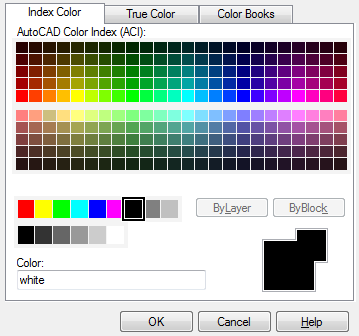

sketch11 Posted December 1, 2020 Author Posted December 1, 2020 OK thanks but what is the way to change the colors as seen in the Index. Not to change in the Plot Styles Table Editor, but to change the Index color, as seen in attached. Quote

sketch11 Posted December 1, 2020 Author Posted December 1, 2020 Great, thanks for advising. Yes, it is a color related question, I was looking to have the first 10 as contrasting (Blue, Red, Green, Magenta, etc). I should have mentioned "as viewed in the AutoCAD Color Index and as viewed in the Drawing as well". But it looks like this is not possible. STB method is not suitable for my purpose. What do you mean by: Quote If you are looking for a specific color/shade I recommend using a true color variant and edit the shading as needed. Expand Is this done in the Plot Styles Table Editor or the AutoCAD Color Index attached above? Quote

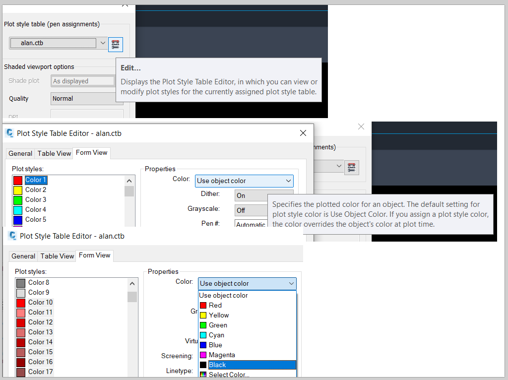

BIGAL Posted December 1, 2020 Posted December 1, 2020 You can edit the ctb and make the pen numbers any colour so Red = 1. In the images here selected a ctb clicked edit, if I understand right you want to change the colour of pens say 10+, you just click on 10 hold shift and drag over all the other pen numbers and select colour BLACK. The easier way is to start with MONO.ctb and reset the colour of the pens 1-9 Quote
sketch11 Posted December 2, 2020 Author Posted December 2, 2020 Thanks BIGAL but as suggested in posts above, it's the Index colors I want to change. Quote
tombu Posted December 2, 2020 Posted December 2, 2020 While there's no way to change the Index Colors why not simply modify your Page setups to have Display plot styles checked? That way the colors shown on the screen will show the same as they plot. Works for both STB's & CTB's. I've used Tim Creary's lisp to toggle it off & on since he posted it in 2008. http://forums.augi.com/showthread.php?t=75802&highlight=ShowPlotStyles#3 1 Quote
