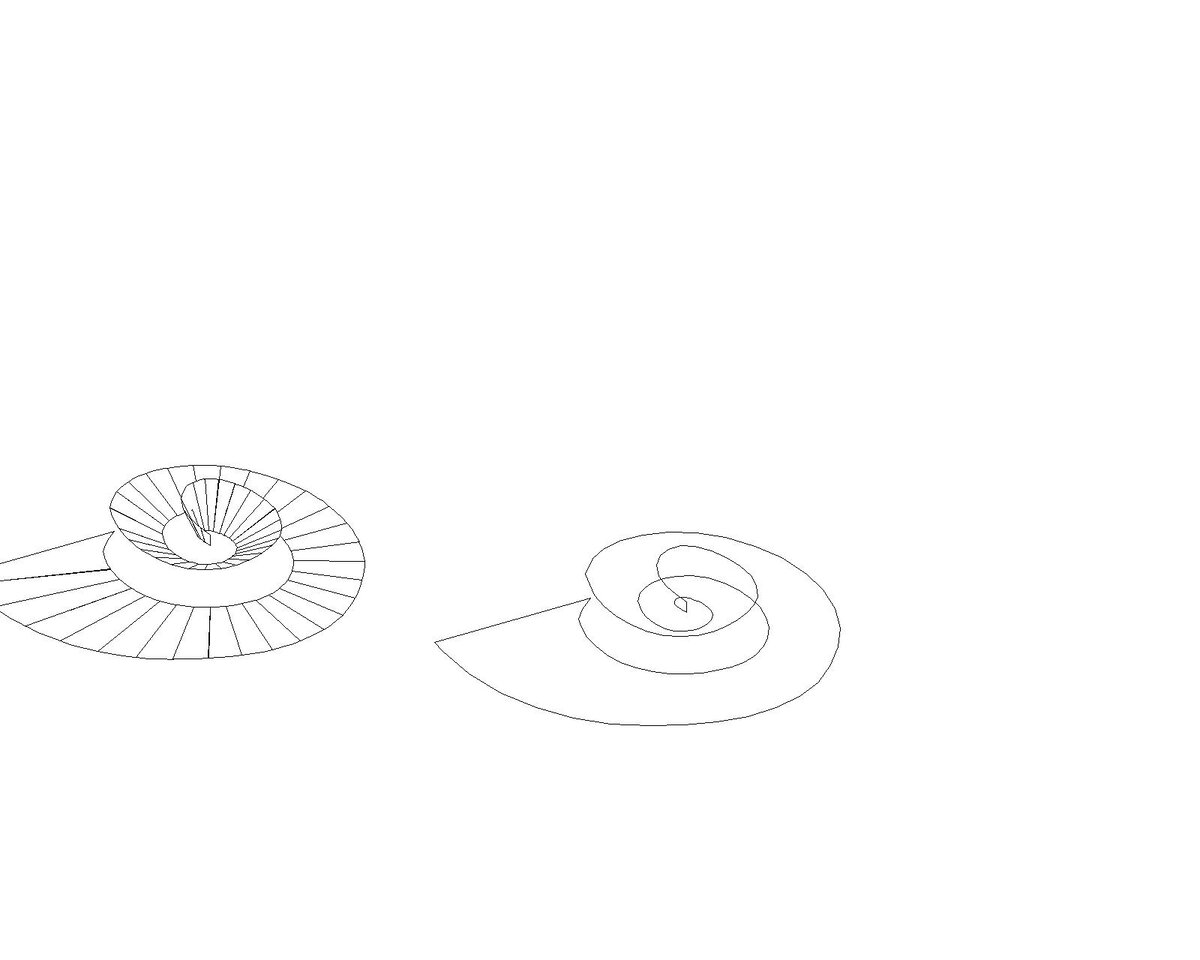

Hello,
I'm looking for help turning this 3d polyline into a solid.  Any suggestions?  Attached is the drawing.  Thank you!

I'm not sure if it will be possible, because of the organic shape. Maybe if you can convert it to a surface and then run the Thicken command to give the surface some thickness?

Hi Paul!
Try the following:
  • Important: The two polyline have to be independent two polylines (The four (line and spline) can be in contact with each other, but should not be connected (_join not allowed) into one object)
  • So you have four items (two lines at the ends, and two spiraling polylines)
  • Use command:
    • _loft
    • select the two spiraling polylines
    • hit enter 2 times
  • Use command:
    • _thicken (with this you give thickness to a surface and it will be converted to a 3D solid)
    • enter the value and with prefix "-" you can define the direction
I hope I helped!
