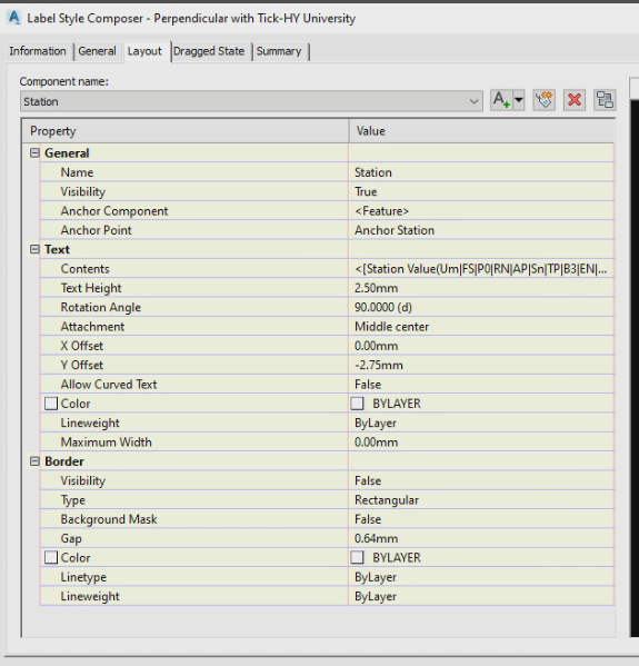

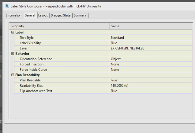

Hi Folks,
    This is driving me a but nuts.  I've been trying to get my station labels to rotate with the viewport correctly.  I like having the + symbol right ON the alignment.  However sometimes when the viewport is rotated 90 degrees it no longer sits right on the plus symbol.  So to get around that I've been creating two label styles one for right side up and another one for when it's rotated 90 degrees.
    Is there a better way to do this?  Here's how my label configuration looks;
image.png.40cc1f4fd141295f01612e9f00da0115.pngimage.png.2e9955d5c9193f435a5a1c5a5b8bc33f.png
