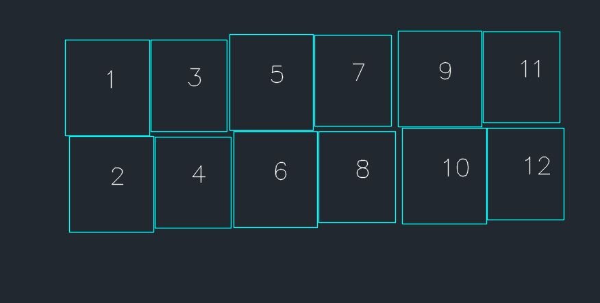

mannybmanago Posted November 25, 2020 Posted November 25, 2020 Hi, We are working on many master plans and part of it is making parcel/lot numberings in sequence. I am trying to find a solution in automating this task since it's thousands and thousands to work on manualy. I know tcount can be use too. Right now I got all the text placements in the centroid of the polygon to be used in tcont. Somehow, I know it left and right or vice versa is the sequence of points having some direction. Does anybody have done this or have lisp for this? It would be a big help. BR/Emmanuel Quote

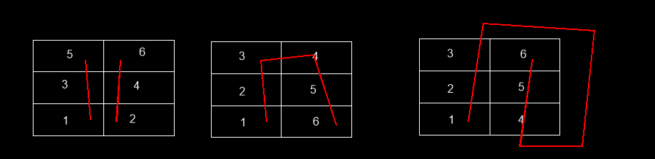

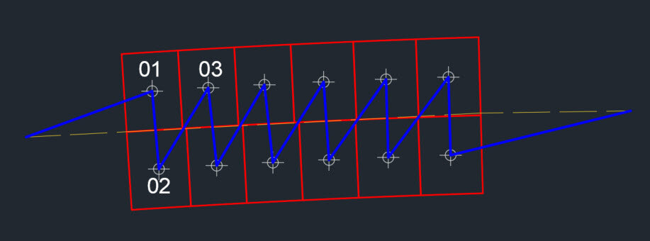

BIGAL Posted November 26, 2020 Posted November 26, 2020 (edited) The automation will depend on stuff like the lots are an individual pline then you could do something like start number then increment eg 1 then 3 5 7 by dragging a line over the lots in sequence stopping and starting would be necessary for a odd even arrangement. Using ssget "F" you could make what you have displayed may need a couple of options Edited November 26, 2020 by BIGAL 1 Quote
mannybmanago Posted November 26, 2020 Author Posted November 26, 2020 Hi Bigal, Yes, the plots or parcels are individual close polylines. My approach would be to just draw a pline in the middle across the a block (or group of plots) and offset this side by side and make a two ordered selections of plots centroid. Then jump from each side and draw pline or add the texts, no idea how i will do this yet. Your approach is also very simple and neat and I will try to code it too. For now, they are stuck with sequence I have attached above. I do copy paste codes from others, a seasonal programming enthusiast in CAD. I also copy the sources links for references unless, i forgot it. Thanks to you all who's been contributing a lot in this forum. BR/Emmanuel Quote

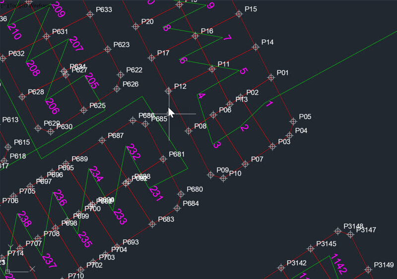

mannybmanago Posted November 27, 2020 Author Posted November 27, 2020 Anyone experiencing this situation where your lisp is running that it doesn't show your progress on the screen like zooming in to entities being process? Then at almost in the end it shows the results. I am processing like 1K to 3K plots for doing some coordinate points and areas of plots and writing it in a text file report. It's a bit slow too. See the attached sample of the text file output of the program. 1418DF-TBQ(5) -224-U-UM-300 - (Parcel No, Area, Points, X, Y - 2.txt Quote
mannybmanago Posted November 27, 2020 Author Posted November 27, 2020 1 minute ago, mannybmanago said: Anyone experiencing this situation where your lisp is running that it doesn't show your progress on the screen like zooming in to entities being process? Then at almost in the end it shows the results. I am processing like 1K to 3K plots for doing some coordinate points and areas of plots and writing it in a text file report. It's a bit slow too. See the attached sample of the text file output of the program. 1418DF-TBQ(5) -224-U-UM-300 - (Parcel No, Area, Points, X, Y - 2.txt 542.45 kB · 0 downloads About 10,626 lines of texts for individual plot points took 15 minutes. Quote
