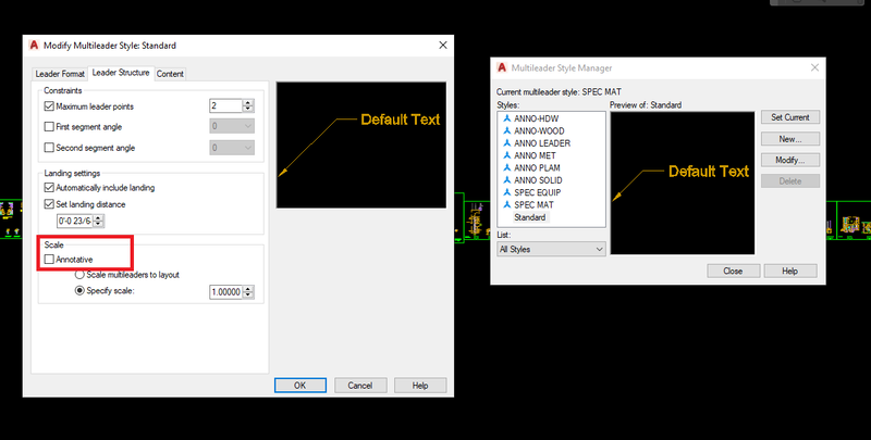

If you intend to put all your dimensions, notes, leaders etc. in paperspace then you need to use a non-annotative dimension style set up to the desired text height and arrowhead size at full size, example 1/8" high text.
If you have not intended to use annotative leaders, text or dimension, then you need to go into your style editor and make sure this box below is not checked.
