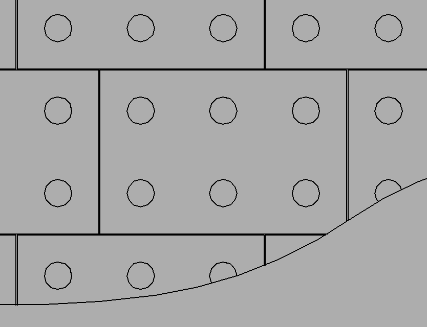

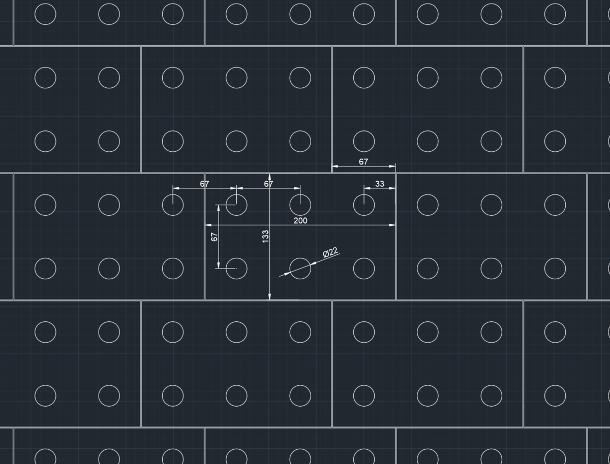

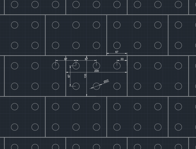

I have managed to create one that gives me the correct block dimensions but I can't seem to get very far with one with the circles. I understand that arcs and circles don't work on hatches so you have to make it work with line segments but I still couldn't get anywhere. At the moment I'm just going to use a preset block and SuperHatch but it would be really good to get a PAT file. The attached image shows what I'm trying to achieve. Note there is a 1mm spacing between the blocks.

With the circles, I started with a 12 sided polygon, a dodecagon. I had to tweak a line or two because they were not pointing in the useful direction. I have always wondered how these automatic pattern file programmes cope with small inconsistencies. All my circle lines touch!
Anyway, I wrote a pattern file. It was very useful having dimensions to work to.

Also I have attached the file itself and a picture.

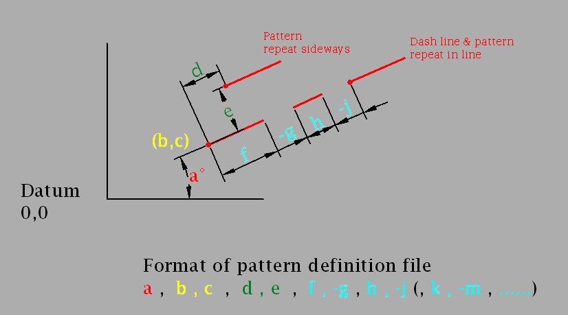

I do not use any artificial help, but prefer to manually follow the pattern of the definition file (as pictured below). If you draw every thing out it is not hard to pick up all the information to make the hatch file.
The first 8 lines, those beginning with 0 or 90 are the block outlines, drawn starting at 0,0.
The next 12 lines are the circles. First of all, i drew a 12 sided polygon, and copied it to form the hatch pattern. Using a circle of radius 11, I drew an inscribed and a circumscribed 12 sided polygon, measured the lengths of both, and then decided to use a side length of 5.75 (cutting down on the number of decimal places). Then I projected one of the lines to see where it hit another circle. It doesn't actually hit one, but 15 rows over it nearly hits one. So I altered the angle from 15° to 14.931417°, not a lot, but enough to make the lines to be in line. Then I redrew the polygon using the new angle, and drew the dash line. I then offset this through similar points on the shapes until a pattern emerged from which I can measure the sideways repeat lengths. Then I worked my way around the shape, picking the lengths and angles from the working drawing. Simple!

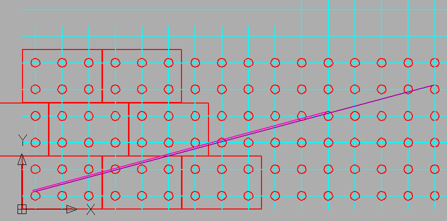

Not having had much practice with circles in hatch patterns, I thought I would try to use a 32 sided polygon (a triacontadigon) in the hatch pattern and see how much accuracy I could get. This makes a difference when the hatch is a long way from 0,0.
Examining the format of the hatch pattern definition, there are angles, coordinates and distances. When one moves far from 0,0 accuracy of the angles is important because the effect is magnified and so are the distances. The coordinate is only the start point of the hatch pattern and thus can be less accurately defined (3 decimal places). One needs to aim for 10 decimal places for angles and distances, but also bearing in mind that the maximum length of a single line of definition is 80 characters.
Because AutoCAD can only display angles to 8 decimal places, I thought to improve that accuracy by trigonometry. When one tweaks the direction of each side of the polygon to aim at the next pattern shape, the tangent of angles can always be defined by integer values. So too the distances. Thus with a spread sheet, one can calculate angles and distances more accurately then AutoCAD can display them.
I managed to rewrite the Tactile Paving hatch pattern with a 32 sided circle with as many decimal places that I could and called it TactilePaving32.pat. As this was a bit of a trial for me, I will not be posting the actual definition file unless someone can't live without it!
The picture below shows some hatches a long way from the origin (coordinates shown) of the two hatch patterns - TactilePaving and TectilePaving32. One can see how less accurate my first hatch pattern was (bits of line spread out all over the place), but as long as it is used close to the origin, it should suffice. But the latest file TactilePaving32 shows almost no separation of the hatch elements.
