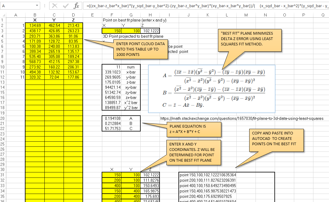

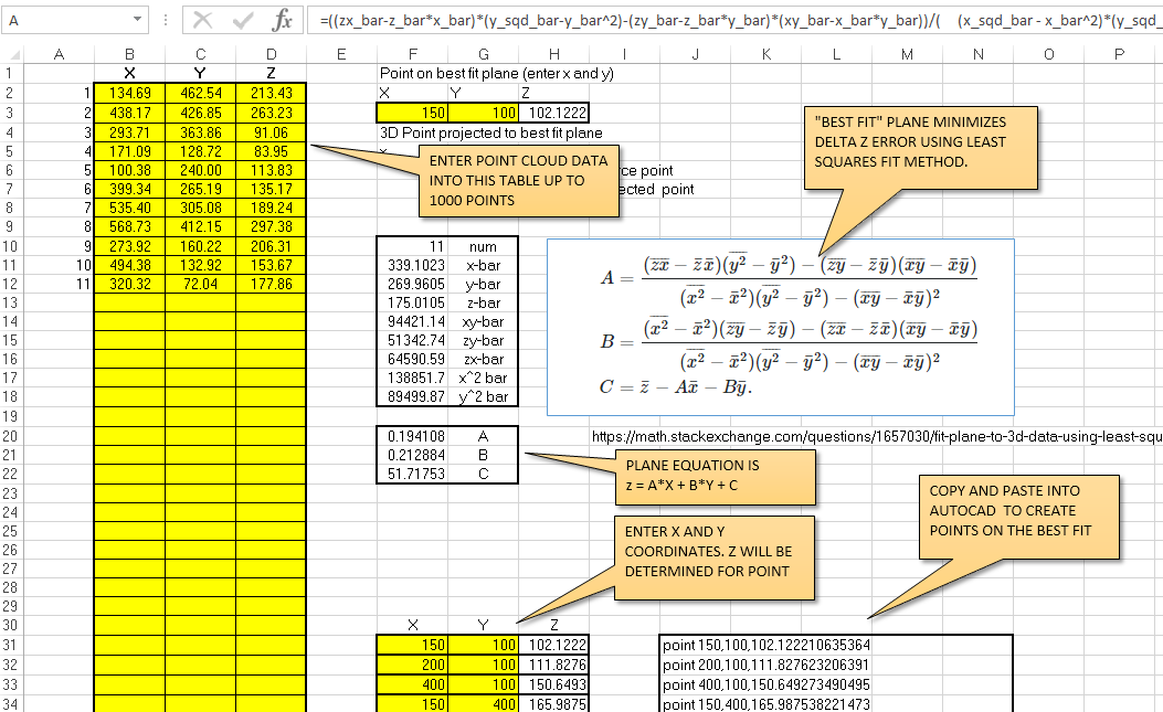

lrm Posted November 18, 2020 Posted November 18, 2020 I created the attached Excel file to calculate the best fit plane to a set of 3D points. It uses the Least Squares Fit method so it minimizes the error in the z direction. It is good for planes that are not too inclined from the xy plane. Vertical planes are a problem. @ibach if this fulfills the first part of your request I could enhance it to project specified points to the plane. point cloud 1.zip Quote
