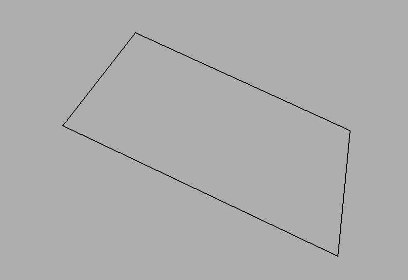

vasilikit4 Posted November 12, 2020 Share Posted November 12, 2020 Hi, I am trying to create a polygon in autocad by lines and using coordinates such as 501231.29 , 3930326.6.. I want to give the coordinates and see the polygon be created.. But the lines go wherever they want and i have this inclination which makes everything worse. What can i do? Quote Link to comment Share on other sites More sharing options...

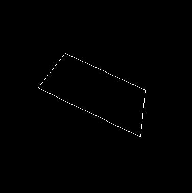

BIGAL Posted November 16, 2020 Share Posted November 16, 2020 Hmmmm I just copied the values from the pdf pasted into notepad 0 501231.43 3930327.00 1 501268.86 3930309.93 2 501266.75 3930287.97 3 501218.73 3930310.73 then a couple of changes and copied all lines pline 501231.43,3930327.00 501268.86,3930309.93 501266.75,3930287.97 501218.73,3930310.73 C pasted to command line Quote Link to comment Share on other sites More sharing options...
eldon Posted November 16, 2020 Share Posted November 16, 2020 On 11/12/2020 at 4:36 PM, vasilikit4 said: Hi, I am trying to create a polygon in autocad by lines and using coordinates such as 501231.29 , 3930326.6.. I want to give the coordinates and see the polygon be created.. But the lines go wherever they want and i have this inclination which makes everything worse. What can i do? @BIGAL, when you read the OP's request and see what forum it is in, it can be disconcerting for a beginner to be entering coordinates and not seeing the lines appear on screen. If you are just drawing, then the default screen is alright. But when plotting UTM coordinates which are large numbers, it can be unnerving if the screen is showing the Equator, whilst you want to be looking at Crete to see your lines. I drew it the same way as you did. I have a fear of transferring numbers from a picture to the screen without mistakes and transposing digits so, for me, copying and pasting, with a bit of text editing is a more reliable way to go. BUT, you did not see the polygon until you did a zoom extents. The OP has a plethora of ways to actually draw the lines, but to SEE them one has to re-direct where to look with Zoom centre. Quote Link to comment Share on other sites More sharing options...

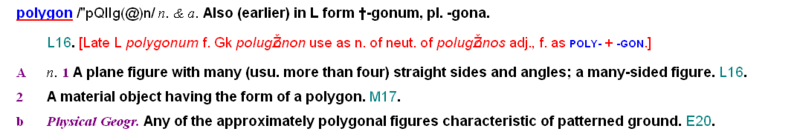

eldon Posted November 16, 2020 Share Posted November 16, 2020 This is from the New Shorter Oxford English Dictionary. Being a student, perhaps the OP did not know that a polygon in AutoCAD is not the same as a polygon in general usage. Quote Link to comment Share on other sites More sharing options...
Berzerker Posted November 16, 2020 Share Posted November 16, 2020 (edited) @eldon Maybe I went to school it a different time but I learned differently than the way we are all talking about. A pentagon has 5 sides, a hexagon has 6 sides, 7 sides a heptagon and 8 a octagon.....etc. All these are polygons polygon [ˈpälēˌɡän] NOUN geometry 1. a plane figure with at least three straight sides and angles, and typically five or more. Edit: As for the above I disagree Three sides are a "Triangle" and 4 sides are a "Square"/ rhombus " no "gon" at the end. You can't have less than 3 sides for one and they start at 5 sides I've never heard of a triangleagon or a squareagon/ rhombusagon Of course none of this has to do with the AutoCad polygon command Edited November 16, 2020 by Berzerker Quote Link to comment Share on other sites More sharing options...
eldon Posted November 16, 2020 Share Posted November 16, 2020 A polygon has straight sides forming a complete circuit and there are regular and irregular polygons. The regular polygons can have names. In the context here, the OP posting in the Student forum, talks about polygons, and you have to see past the language to get to the meaning. The OP's coordinates did not start at 0,0 because they were trying to plot UTM type coordinates, which have zero on the equator. The polygon was on Crete. Quote Link to comment Share on other sites More sharing options...
