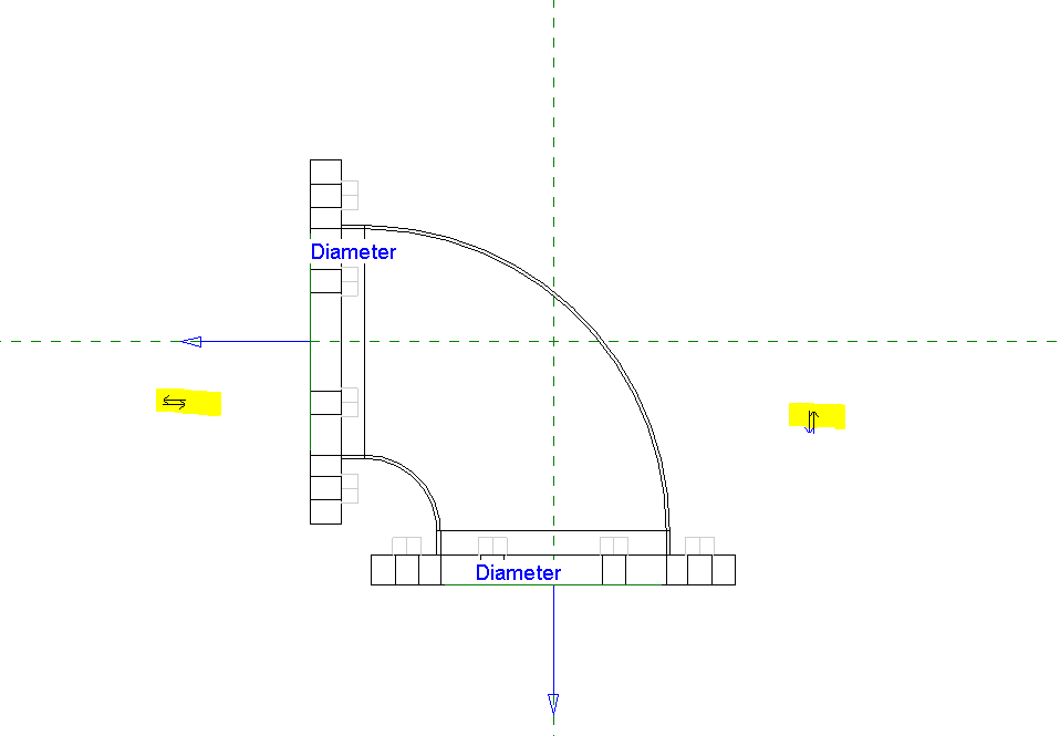

Hello forum!
Looking for help concerning the subject of flipping or rotating the family
Rfa attached, Not that I'm lazy but if someone can apply this parameter on rfa, it will be greatly appreciated and will contribute to my knowledge of revit
Thanks

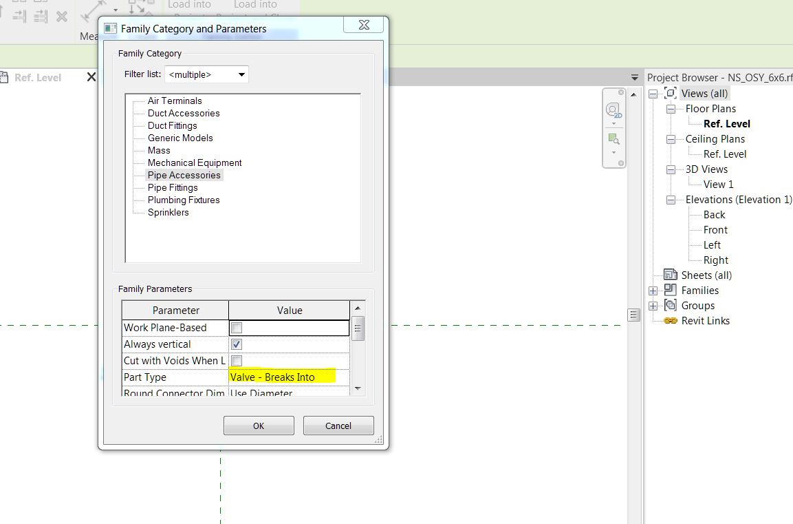

Thanks for solution!
One of those cases when was easy but just didn't appear graphically.

Assigning family to right category brings those rotation and flip markers automatically
