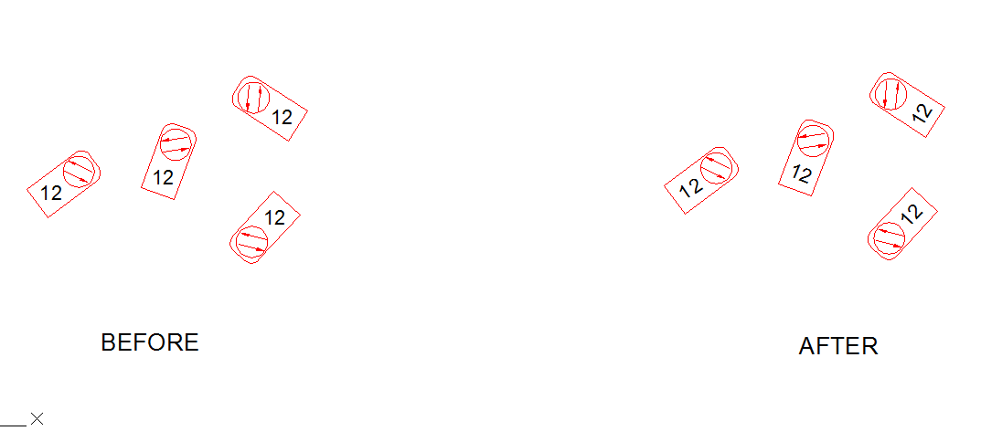

         Help required on making the font to readable angles,  i have created a block with Annotative, so it always in 0 degree, but now i need it to be in Most readable angle inside the blocks , wherever i insert it in drawing & rotates it.
could someone help me to resolve it.
attached screenshot & sample drawing of my requirements.
sample.dwgFetching info...

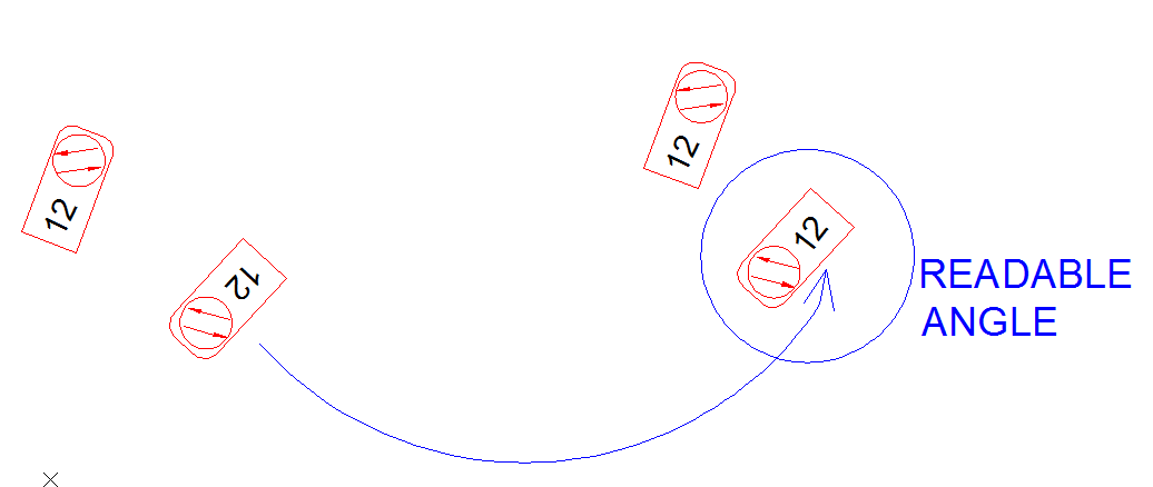

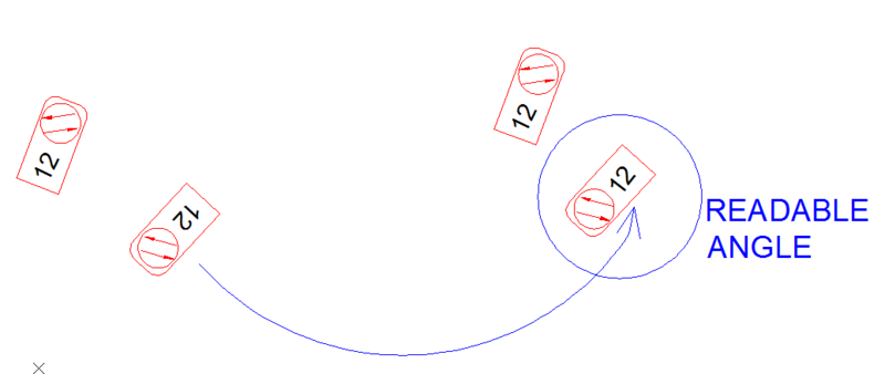

Actually i want the Text inside that Block to be Rotated as per the block angle, i can able to that by applying rotational action inside Dynamic block,
but in some angles Text in getting into inverted position, i need that to be kept in Most readable angle, please check the below screenshot.
i tried with the above provided solution but it just places the angle of the Block in the place of a text.
Could you please help me resolve it.
Quickly written:
(defun c:fixatt ( / i s )
    (if (setq s (ssget "_:L" '((0 . "INSERT") (66 . 1))))
        (repeat (setq i (sslength s))
            (foreach  a (vlax-invoke (vlax-ename->vla-object (ssname s (setq i (1- i)))) 'getattributes)
                (if (and (vlax-write-enabled-p a) (= :vlax-false (vla-get-invisible a)))
                    (vla-put-rotation a (LM:readable (vla-get-rotation a)))
;; Readable  -  Lee Mac
;; Returns an angle corrected for text readability.
(defun LM:readable ( a )
    (   (lambda ( a )
            (if (and (< (* pi 0.5) a) (<= a (* pi 1.5)))
                (LM:readable (+ a pi))
                a
        (rem (+ a pi pi) (+ pi pi))
(vl-load-com) (princ)
Edited by Lee Mac

Thank you so much Sir, i worked like a charm :)
Thank you so much for all the special things you do Sir.
