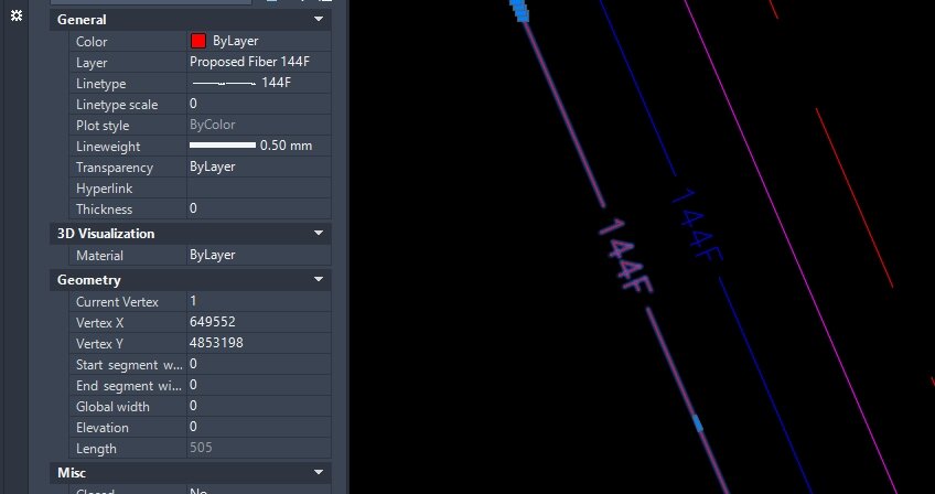

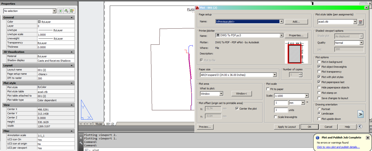

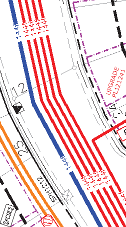

amb2301 Posted November 6, 2020 Share Posted November 6, 2020 (edited) Hi Friends, i have created a new linetype with the text 144F on it, it looks fine in Model view & layout, but while plotting that file into pdf, the text inside that linetype getting blurred & not appearing properly, could someone help me to resolve this issue.symbol & line types.lin i have attached the required screenshots. Note: i have created the line type using the TEXT, i m attaching the line type here. sample1.dwg Edited November 6, 2020 by amb2301 attachment dwg Quote Link to comment Share on other sites More sharing options...
tombu Posted November 6, 2020 Share Posted November 6, 2020 Lineweight is applied to shp fonts. I prefer using TrueType fonts in linetypes for that reason. Experiment some characters like underscores (and a few TrueType fonts) which appear as lines in TrueType fonts are often displayed with lineweight but shouldn't affect your example. You could simply change the lineweight if that's an option. Most users & offices have different opinions of what font is used for STANDARD text style. I'd only use text styles that identify the font like "Swiss Light" "Arial Narrow" or "Romans". That way your text and linetypes should display the same for other users. 1 Quote Link to comment Share on other sites More sharing options...

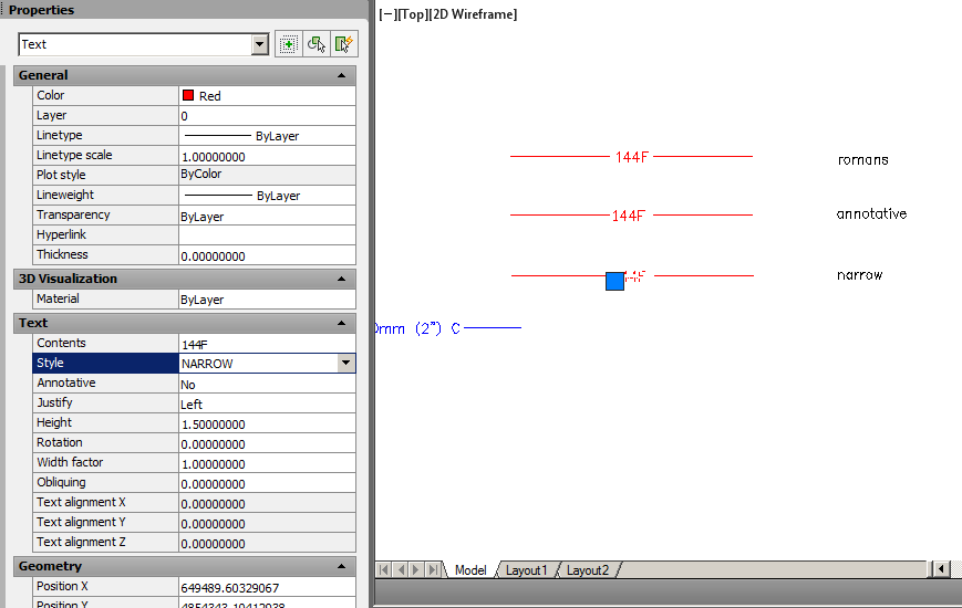

amb2301 Posted November 6, 2020 Author Share Posted November 6, 2020 Hi tombu, i have created a new line type & tried creating with different font styles like ROMAN & NARROW, But still while plotting its not appearing clearly. could you please help me on it. please check the screenshots. Quote Link to comment Share on other sites More sharing options...
pkenewell Posted November 6, 2020 Share Posted November 6, 2020 @amb2301 Look at the OBJECT lineweight in Properties. The lineweight is set to 0.5mm. It will come out thick regardless of what you use. Change the object lineweight. Quote Link to comment Share on other sites More sharing options...
amb2301 Posted November 6, 2020 Author Share Posted November 6, 2020 Thanks pkenewell, yes, i m aware of the lineweight set to 0.5mm, because after plotting , i m expecting the PDF out like as shown below, In 100% view of PDF file, the text are appearing clearly & line weight also appears properly, i m trying the same from my dwg to pdf, but i cant Quote Link to comment Share on other sites More sharing options...

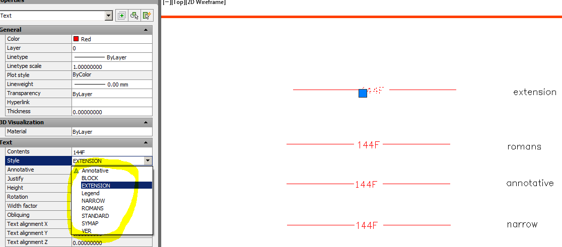

amb2301 Posted November 6, 2020 Author Share Posted November 6, 2020 (edited) Im getting only this much of font styles, which one i have to use it, i tried with almost all type of fonts for creating linetypes, still in pdf its not appearing properly. Edited November 6, 2020 by amb2301 Quote Link to comment Share on other sites More sharing options...

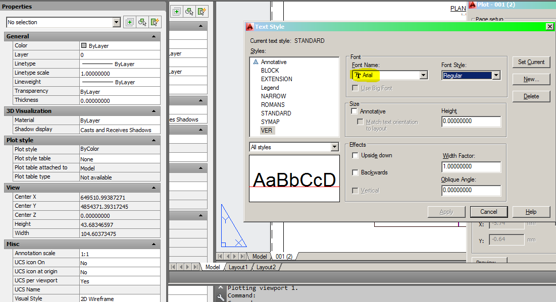

Roy_043 Posted November 6, 2020 Share Posted November 6, 2020 Change the Standard text style to a TTF font. 1 Quote Link to comment Share on other sites More sharing options...

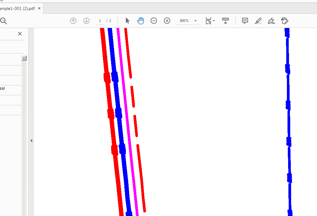

amb2301 Posted November 6, 2020 Author Share Posted November 6, 2020 Hi ronjonp, Thanks for looking on it, i plot the file provided by you, but still the 144f text not appearing the PDF, please check the attached plotted file. please hep me to resolve it. sample1 (1)-001 (2).pdf Quote Link to comment Share on other sites More sharing options...
amb2301 Posted November 6, 2020 Author Share Posted November 6, 2020 Hi Roy_043, Thanks for looking on it. how to change it, i have only following font styles. Quote Link to comment Share on other sites More sharing options...

amb2301 Posted November 6, 2020 Author Share Posted November 6, 2020 even i tried with following TT Arial font, still the same happens Quote Link to comment Share on other sites More sharing options...
amb2301 Posted November 6, 2020 Author Share Posted November 6, 2020 1 hour ago, Roy_043 said: Change the Standard text style to a TTF font. Thanks Roy_043 & Ronjonp, I tried with different TTF font, it got resolved. Thank you so much for your Help!!! Quote Link to comment Share on other sites More sharing options...
tombu Posted November 7, 2020 Share Posted November 7, 2020 22 hours ago, amb2301 said: Thanks Tombu & pkenewell for looking on this post, i will try changing the font style in linetype & get back to you You have to use Text Styles in linetypes. You have to assign a font to a Text Style and then use the Text Style in the linetype. Sadly complex linetypes were introduced in R13 and the concept of referencing fonts directly like you can in Mtext wasn't introduced until R14. https://forums.augi.com/showthread.php?133959-Font-referencing-Background-Masking-in-Complex-Linetypes Quote Link to comment Share on other sites More sharing options...
