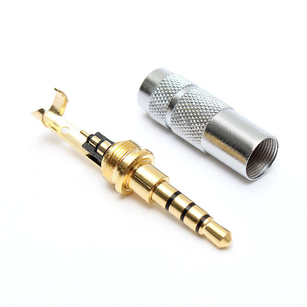

Both your reponses are greatly appreciated! I feel like this might actually be doable. Here's an example of the innards and housing of a regular 3.5mm jack plug. Don't know if this is clear enough to tell what kind of screws that is.

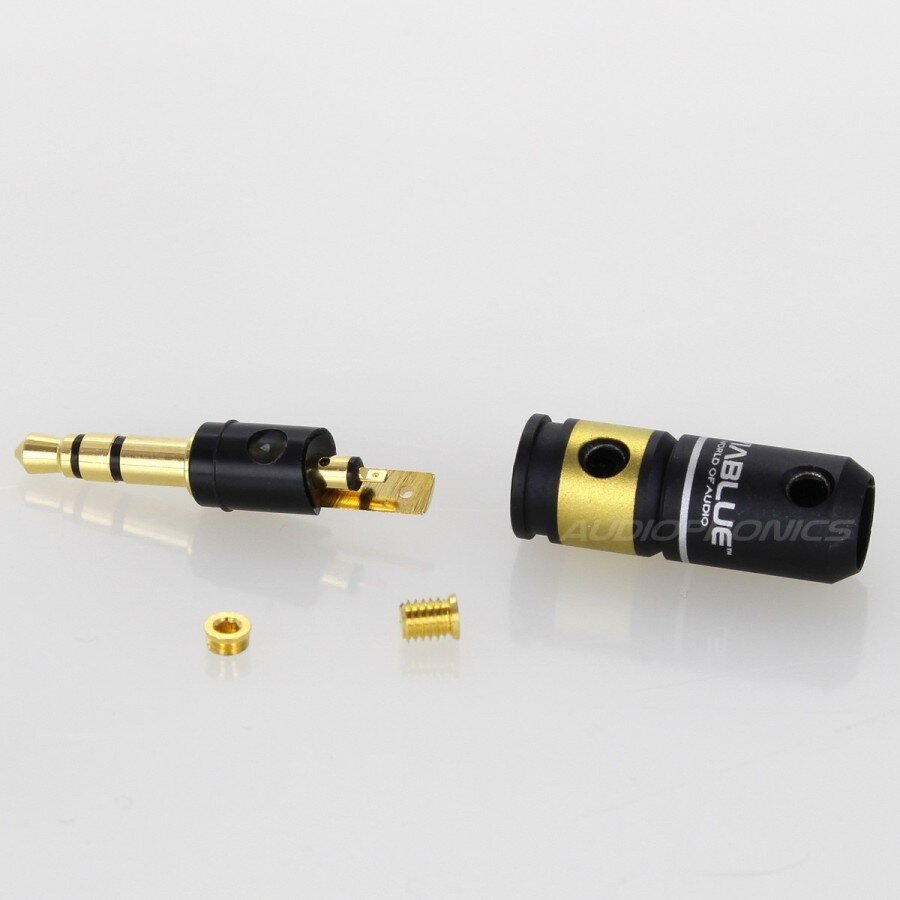

There are other type of plugs, namely the Viablue ones, which are extremely high-end and expensive, and don't use a screw like this, but a smaller screw on the side holding the housing so it's easily dismantled. It might actually be easier to design a piece using these plugs rather than the one posted above. I could just design the housing with a threaded hole placed correctly, and use the Viablue innards to screw my housing back onto it. The second screw is used to modify the diameter of the back opening.

In my quick search I have found no chart for a 3.5 mm jack plug. From what I gather it's up to the manufacturer on what threads they use. I would buy one that can fit what you want to do with it and measure it and find out what threads are on it. I'm sure they will go by some kind of standard. The 3.5 mm is the size of the plug end that goes into the device "If I'm not mistaken" and has nothing to do with the housing size. I'm sure these can be picked up at home depot or other similar store.
  • Thanks 1
I'll order some and try that. Yes, 3.5mm in the size of the tip that gose into your audio in.
If the tip is 3.5 mm (= 0.138 in.) I would estimate from the photo that the thread is about twice as big and that the thread is about 1/4 in. so a 1/4  20 UNC  or UNF might be a good guess.  Again, take the part to a hardware store and see if a 1/20 bolt smoothly screws into the part.
