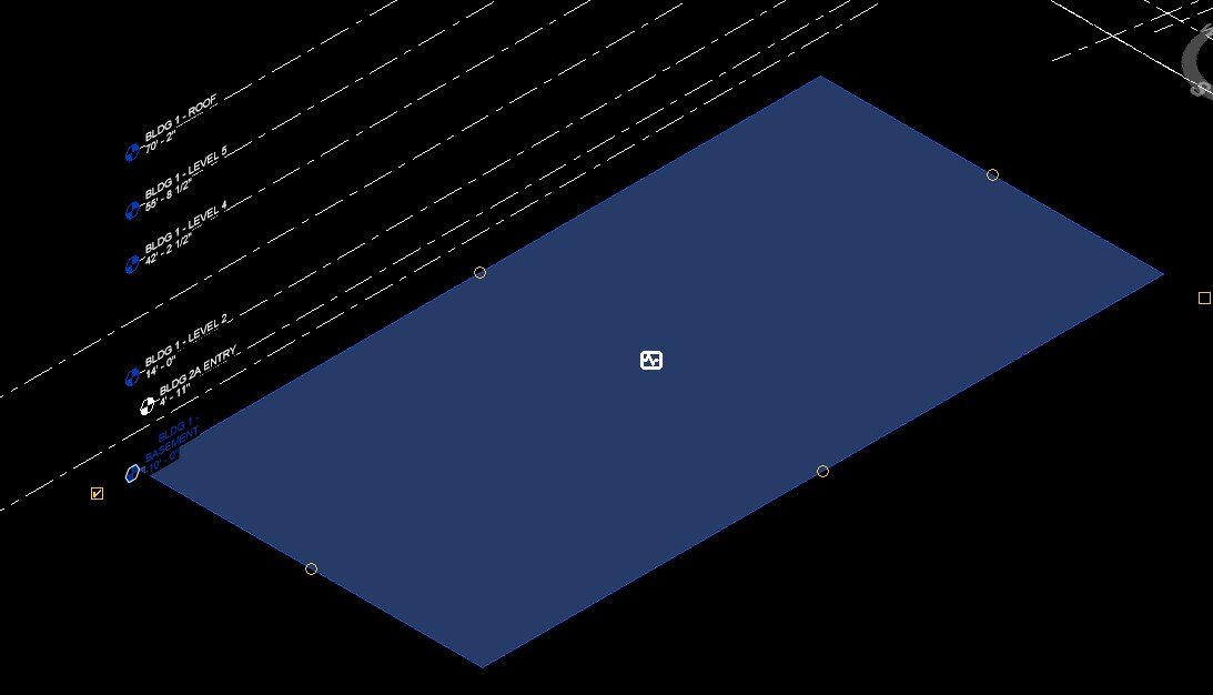

Have you tired adjusting the 3D extents?

The first question I have is: Are these levels that are "in the way" your Levels in your parent model, or are these the levels inside the links?
Levels should be set up in your model, although many people don't do this as entry level designers so that's why I asked. Assuming you do, make sure you hide levels automatically using Filters in the Links, which solves one problem. Rob has the other part of the issue, which is adjusting the 3D extents of the level themselves so it doesn't overlap into the other building, which in turn acts as an automatic visibility control.
