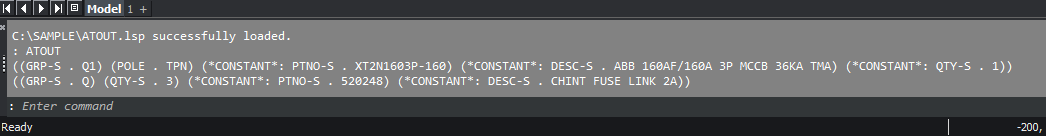

Hello, i'm very new to lisp programming and i need some help to add a table to the current code (found the code in this forum too). A table that would show the all the attributes or details of QTY, PTNO, and DESC would be good. Thank you!
This is the code:

Currently, i have the attributes shown at the bottom, at the command center, like this. currently.thumb.png.ba883b5448a5fb7f5441cb10d3b8f534.png

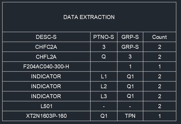

However, i want it to look like this.
Does anyone know how to edit the code so that it will be shown like the one in the table?

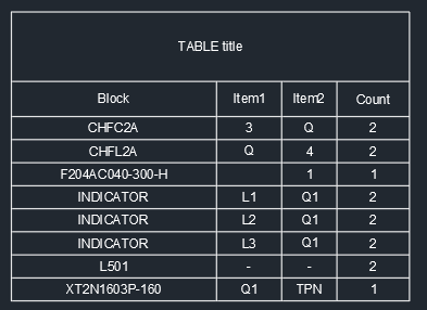

1 hour ago, BIGAL said:
I don't think that's what he's after. That one counts all blocks.
I built this one a long time ago, though I never had to use it, so I'm not sure if it will yield the intended result:

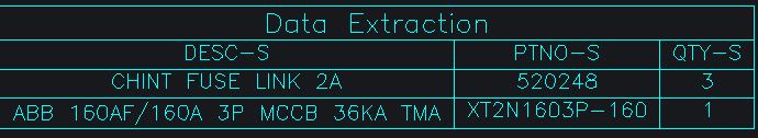

To desean like as Jonathan has suggested,  I have something that creates a table of blocks and attributes, you can have as many block names as you like the blocks can have can as many attributes as you like, it sorts  totals based on Blockname att1 att2 up to att 5. But can have as many attributes as you like tested on block with 25 attributes.
Door1 Black Silverhandle 25
Door1 Black Goldhandle 15
Door2 Black Goldhandle 12
Door2 Silver Goldhandle 15
Door3 Silver Goldhandle embossedfinish 15
Its not a freebie but cheap.
If you post a sample dwg happy to test to see if its what you want.

Thank you Jonathan for the code! Unfortunately, the result is not what i'm looking for. Thanks again!

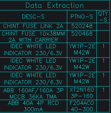

Does it extract the attributes that I want, such as the Desc-S, Ptno-S, and QTY-S? I have attached a file for sample.
sample blocks for test.dwg
On 11/7/2020 at 9:37 AM, BIGAL said:
This is what I ended up with is it what you want ? Can supply a trial version.
Unfortunately, it is not what I want. Thanks though!
2 hours ago, BIGAL said:
You need to post what you want is it just the title stuff then you can just edit that. Just change, Block item1 Item2 Count.
Information shown at command line.
I just want the DESC-S, PTNO-S, QTY-S to be shown in a table rather than at the command line, like this.
For the title stuff, I know I can just edit it.
Edited by desean
I think I see what you're after...
(defun c:test ( / i rtn ss tags)
    (setq tags	; these are the tags. They will appear left to right sorted in the order below
	       "DESC-S"
	       "PTNO-S"
	       "QTY-S"
    (if (setq ss (ssget '((0 . "INSERT"))))
		(setq rtn
			 (cons
			     (mapcar 'cdr
				     (vl-sort
					 (vl-remove nil
					     (mapcar
						 '(lambda (x / ps)
						      (if (setq ps (vl-position (vla-get-TagString x) tags))
							  (cons ps (vla-get-TextString x))
						 ((lambda (x) (append (vlax-invoke x 'GetConstantAttributes) (vlax-invoke x 'GetAttributes)))
						     (vlax-ename->vla-object (ssname ss (setq i (1- i))))
					 '(lambda (a b) (< (car a) (car b)))
			     rtn
	    (JH:list-to-table (vla-get-ModelSpace (vla-get-ActiveDocument (vlax-get-acad-object)))
		(append '(("Data Extraction")) (list tags) (vl-remove nil rtn))
		(getpoint "\nSpecify insertion point for table: ")
		(getvar 'ctablestyle)
;; JH:list-to-table --> Jonathan Handojo
;; Creates a table from a list of lists of strings
;; space - ModelSpace or Paperspace vla object
;; lst - list of lists where each list is a list of strings
;;	=> if you wish to insert a block in the cell, prefix using "<block>" followed by the block name
;;	=> e.x. if you want to insert the block "TestBlock1", input the string as "<block>TestBlock1"
;; pt - Insertion point of table (2 or 3 reals)
;; tblstyle - Table style to use
(defun JH:list-to-table (space lst pt tblstyle / i j lens ncols rows totlen txt vtable)
    (setq ncols (apply 'max (mapcar 'length lst))
	  vtable (vla-AddTable space (vlax-3d-point pt) (length lst) ncols 10 10)
    (vla-put-RegenerateTableSuppressed vtable :vlax-true)
    (vla-put-StyleName vtable tblstyle)
    (repeat (setq i (length lst))
	(setq rows (nth (setq i (1- i)) lst))
	(vla-SetRowHeight vtable i (* 2 (vlax-invoke vtable 'GetCellTextHeight i 0)))
	(repeat (setq j (length rows))
	    (setq lens
		     (cons
			     (abs
				 (apply '-
					(mapcar 'car
						(textbox
						    (list
							(cons 1 (setq txt (nth (setq j (1- j)) rows)))
							(cons 7 (vlax-invoke vtable 'GetCellTextStyle i j))
			     (vlax-invoke vtable 'GetCellTextHeight i j)
			 lens
	    (if (eq (strcase (substr txt 1 7)) "<BLOCK>")
		    (setq blk (substr txt 8))
		    (if (and
			     (wcmatch (getenv "PROCESSOR_ARCHITECTURE") "*64*")
			     (vlax-method-applicable-p vtable 'setblocktablerecordid32)
			 (vla-SetBlockTableRecordId32 vtable i j (vla-get-ObjectID (vla-item (vla-get-Blocks (vla-get-ActiveDocument (vlax-get-acad-object))) blk)))
			 (vla-SetBlockTableRecordId vtable i j (vla-get-ObjectID (vla-item (vla-get-Blocks (vla-get-ActiveDocument (vlax-get-acad-object))) blk)) :vlax-true)
		(vla-SetText vtable i j txt)
	(setq totlen (cons lens totlen) lens nil)
    (repeat ncols
	(vla-SetColumnWidth vtable (setq ncols (1- ncols))
	    (apply 'max
		   (vl-remove nil
		       (mapcar
			   '(lambda (x)
				(nth ncols x)
			   totlen
    (vla-put-RegenerateTableSuppressed vtable :vlax-false)
    vtable
Edited by Jonathan Handojo
  • Thanks 1
	       "DESC-S"
	       "PTNO-S"
	       "QTY-S"
		(setq rtn
			 (cons
			     (mapcar 'cdr
				     (vl-sort
					 (vl-remove nil
					     (mapcar
						 '(lambda (x / ps)
						 (vlax-invoke (vlax-ename->vla-object (ssname ss (setq i (1- i)))) 'GetConstantAttributes)
			     rtn
	    (setq lens
		     (cons
			     (abs
				 (apply '-
					(mapcar 'car
						(textbox
						    (list
			 lens
		    (if (and
    (repeat ncols
	    (apply 'max
		   (vl-remove nil
		       (mapcar
			   '(lambda (x)
				(nth ncols x)
			   totlen
    vtable
Hey, thanks so much! This is exactly what i'm looking for. But there's a slight bug with QTY-S. It does not show for some of the components.
I already re-edit the code, I forgot it wasn't just the constant attributes, but also the changing attributes. Refresh the page
  • Thanks 1
Oh wow! It works, thank you so much!!!
Jonathan, do you know how can I expand the width of the table?
