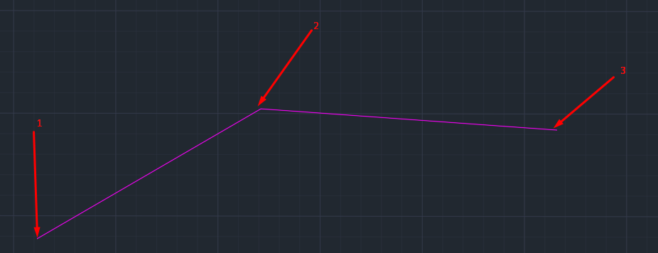

Еhis problem has already been discussed but I wanted to slightly alter it for myself. Now in these lines he takes a common point. And subtracted, starting from the middle (common point). How to make everything go from left to right. That is, the starting point, then the middle (bend point) and the end point. https://forums.autodesk.com/t5/visual-lisp-autolisp-and-general/calculate-angle-between-two-lines/td-p/803914 FILE ATTACHED

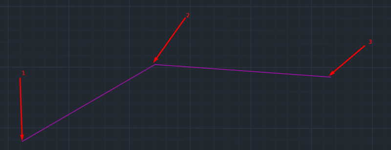

To get point 1,2,3 and get angle of point 2
I'll translate it in a better language for you BIGAL, simply put:
Click three point 1, 2, and 3 and have the function return the inside angle formed by the points 123. I'll leave the rest to you 😉.

(defun c:test ( / p1 p2 p3)
    (and
	(setq p1 (getpoint "\nSpecify first point <exit>: "))
	(setq p2 (getpoint "\nSpecify second point <exit>: "))
	(setq p3 (getpoint "\nSpecify third point <exit>: "))
	(princ (strcat "\nInner angle formed: " (rtos (rtod (JH:InnerAngle p1 p2 p3)) 2 1) "°"))
(defun rtod (ang) (* 180 (/ ang pi)))
;; JH:InnerAngle --> Jonathan Handojo
;; Returns the smaller angle between three point p1 p2 p3
;; with p2 as the pivot, in radians.
(defun JH:InnerAngle (p1 p2 p3 / 2p ang)
    (setq ang (- (angle p2 p3) (angle p2 p1)) 2p (+ pi pi))
    (while (not (<= 0 ang 2p)) (if (< ang 0) (setq ang (+ ang 2p)) (setq ang (- ang 2p))))
    (if (> ang pi) (- 2p ang) ang)

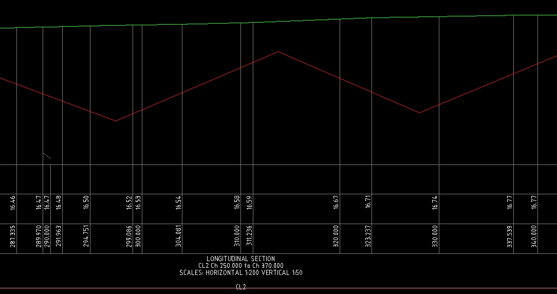

Thank you! Yes now this lisp almost works as desired but not scale the result that comes out. In the example, you can see how it is multiplied by 0.1
I don't get what the scale factor is supposed to mean. I merely assumed that you want to return the inside angle formed between 3 points. Can you elaborate further on how the calculation works?
In this example you see this calculation. This is required for the longitudinal profile. When hor 1:500 and vert 1:50.
(setq pt2 (getpoint))
(setq ang1 (getangle pt2 "\nSelect angle: "))
(setq ang2 (getangle pt2 "\nSelect angle: "))
(setq ung1 (rtod (sclang ang1 0.1)))
(setq ung2 (rtod (sclang ang2 0.1)))
(setq ung (abs(- ung1 ung2)))
(princ "\nAngle on ")
(princ ung)
(defun rtod (ang) ; rad to degree
(setq ang (* 180.0 (/ ang pi)))
Oh, I see... I thought the image you post was the plan view and was sloping in 3D going into the screen, but that was actually the side view of the drainage. My mistake.
(defun c:test ( / p1 p2 p3 hz vt dp)
    (and
	(setq hz (getreal "\nSpecify horizontal scale <exit>: "))
	(setq vt (getreal "\nSpecify vertical scale <exit>: "))
	(setq dp (cond ((getreal "\nSpecify depth scale <1.0>: ")) (1.0)))
	(mapcar
	    '(lambda (x / dir)
		 (setq dir (mapcar '- (eval x) p1))
		 (set x (mapcar '(lambda (a b c) (+ a (* b c))) p1 dir (list hz vt dp)))
	    '(p2 p3)
	(princ (strcat "\nInner angle formed: " (rtos (rtod (JH:InnerAngle3D p1 p2 p3)) 2 1) "°"))
;; JH:InnerAngle3D --> Jonathan Handojo
;; Adaptable with 3D points
(defun JH:InnerAngle3D (p1 p2 p3)
    (acos
	    (apply '+ (mapcar '* (mapcar '- p1 p2) (mapcar '- p3 p2)))
	    (* (distance p2 p1) (distance p2 p3))
;; ArcCosine  -  Lee Mac
;; Args: -1 <= x <= 1
(defun acos ( x )
    (if (<= -1.0 x 1.0)
        (atan (sqrt (- 1.0 (* x x))) x)
This is adaptable in 3D, so in addition to the horizontal and vertical scale, you can also specify the depth scale too.

A typical dwg see the scales it is helpful when the OP post a true idea of what they want. "30 profiles with water pipe lines" water pipes have a limited number of off the shelf bends else custom bends generally for large pipes 375mm+
