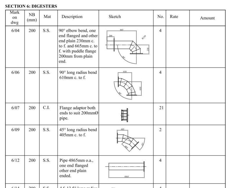

i have attached a image for reference (Labeled Example).
The AutoCAD schedule was done manually.

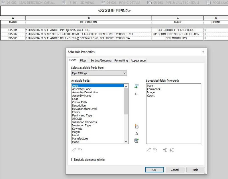

I have created a relatively automated Revit Schedule, but it needs more refinement and i do not know how to proceed.
i have added screen shots to show the schedule i have created.
I have used a Tag family to tag the pipe fittings according to my sequence. (This is fine)
The comments (description) i have to manually type. (I would like this Automated including the length of the pipe/angle of the elbow/distance the puddle flange is from the flange etc taken from the fitting)
The image is a screen shot which is added as a image (this is not ideal , i would like an image that can be dimensioned as in the AutoCAD schedule or as in a window or door legend.)
The count is calculated by the number of pipes that have the same tag (This is fine)

You'll have to bend to Revit's will on this one. My suggestion to you is to first accept that you will not achieve an exact replica of your previous workflow with automated data, simply because your previous workflow was a completely manual system and you're now using an automated system that is based on logic and has pre-defined limitations which can only be overcome through custom programming.
That aside, here are some suggestions for you to try and see how it works for you.
  1. The description will be a manual entry, and should be, since it's giving precise instruction that is unique compared to every other part (from what I can tell). How you're doing it is fine.
  2. I would consider removing as much from the description column as possible that could be automated. For instance, pipe sizes and pipe lengths. Create new columns for this and let it be automated for QAQC purposes. Utilize the power of bidirectional data that's populated automatically.
  3. I could be wrong, but as of now I don't think there's any way to achieve the dimensioning inside the graphic itself, so you'll have to remove that from your workflow.
    1. With that said, look into a new workflow such as utilizing Assemblies. This is a great way to create automated spools, to which you could place callout bubbles very easily and tag in these auto-generated views and sheets.
