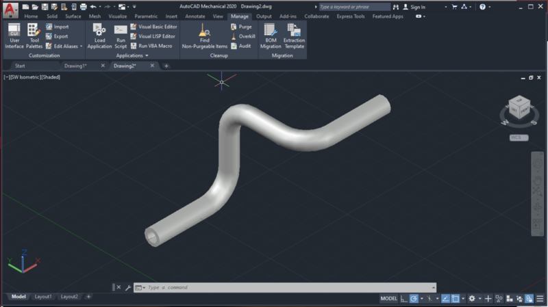

here is a sample drawing and the code. Am  using  Autocad mech.  the code recognizes only full pipes but i need it to recognize hollow pipes.

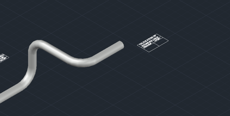

hi guys, I am actually writing an autolisp program to calculate head loss in 3D hydraulic networks in Autocad mech but my code apparently has some issues. I will like some help.
It either returns the error "bad function : TAutocad variable setting rejected: CMDecho nil" or an empty table
Here is the code
