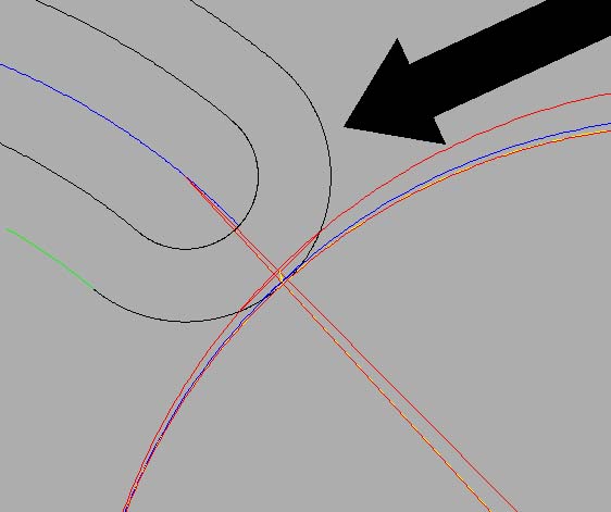

I've attached a drawing with my problem in which I can't figure out the construction for finding the fillet between a point (the arrowed corner on the bottom top left rectangle) and on a tangent of a half circle (also with an arrow). Since the radius is unimportant for this drawing, and is unknown anyway, i know there is an infinite number of fillet radius that i could use but i am finding it hard to find one that doesn't cut into the vertical line of the rectangle which is the only other requirement.
Can anyone enlighten my?

I'm having a bit of trouble understanding what you reall want - take a look at the screenshot below, is this something like what you're after? The white line between the cheese doodle shape and the square is my edition (it was yellow in my ACAD :x)
Sorry for being unclear. but yeah, that's what i was after. Care to explain how you got arc.

As far as i can tell the centre of the circle has to be on the horizontal extension of the rectangle to avoid cutting into it. Can i do this using the Arc. Suppose Start, Centre, End but that's messy.
There must be a better way, i hope.
ok, I messed around a bit more with this - and the easiest way I found to get the result is to use a Polyline - here's step by step what I did, and the result looks like the image I posted earlier
Started PLINE
First point: the bottom right corner of the rectangle
second point: top right corner of the rectangle
press A to change the line to a Arc
third point: midpoint of right arc of the cheese doodle.

I think that this is one of those cases where there is no clear cut graphical solution. You can be systematic and draw a sucession of circles and get very close :o
Thanks Tiger, the polyline method works well. Never drew an arc with a polyline before: very interesting.
