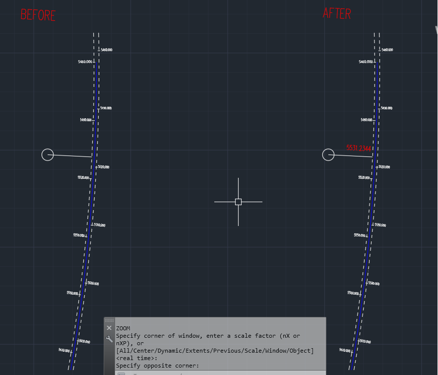

Is there a LSP that can Mark or Check the  specified marking  on a existing chainage
its like there Is a item on the left and when I draw a line, he will specify what chainage it was on
a chainage marking on Plan view
I browse already the forum and ended up with chm.lsp which only good for elevation chainages

I am not sure if this will do what you want but look for this: "StationingPolyline.LSP" by Raymond RIZKALLAH.
I got a look at stationing polyline.
 the command ST3 is cool, however it only marks the from point A length to point B length of the existing length of polyline,.
how about if there is already a imaginary length,.
like the one in my picture,, there is already of 5460 existing chainage,,
There are numerous chainage lisps out there they all use the getpointatdist or the opposite the getdistatpoint VL functions, so you can pick a point on a pline and get its distance back to start point. You could also do add a chainage where the start point is not 0.0
The problem was with your dwg the white broken lines were not a continuous pline. You also need to look at how to apply what is the start chainage so it can be added to the distance retrieved.
Is the chainages of known points always there as can do a read text get chainage and what the start chainage is ? Hence delay in posting code. They are mtext as well so a bit more to strip out the values. I have allowed for "Ch 5000.5" etc.
It is expected that as the chainages are labelled the pline has a correct start point.
Follow the prompts pick pline, pick existing chainage text pick corresponding chainage point, then pick points, press Enter to exit. I will leave it to you make sure text style and side is correct.

  • 7 months later...
ESPERO SEA LO QUE NECESITAS COMPRARTO PARA QUE ALQUIEN PUEDA MODIFICAR EL ARCHIVO PARA QUE EL TEXTO APAREZCA COMO EN EL SIGUIENTE
EJEMPLO :  PK 12+450,45 m.
