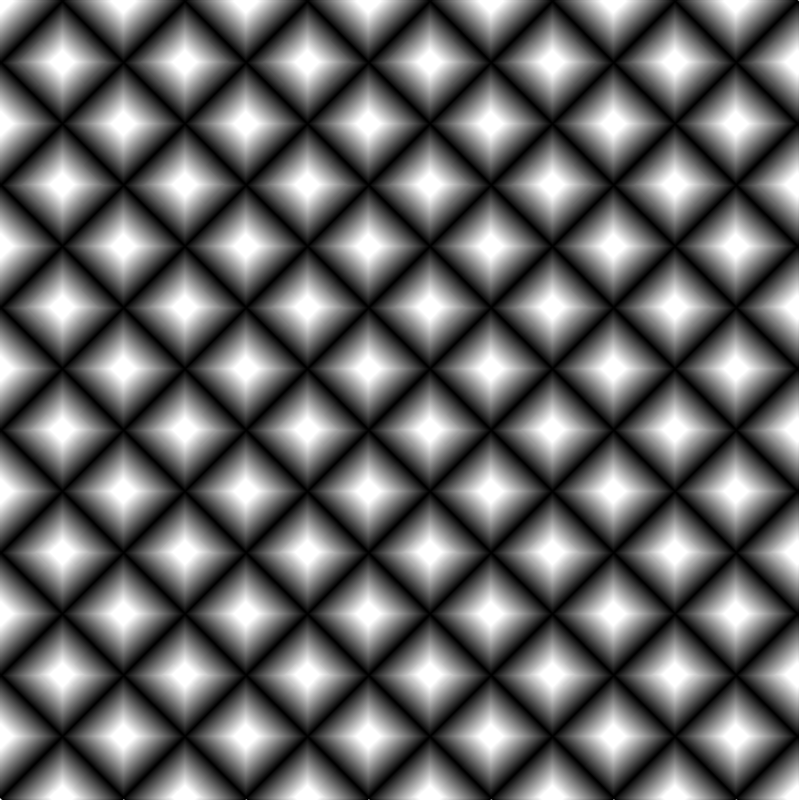

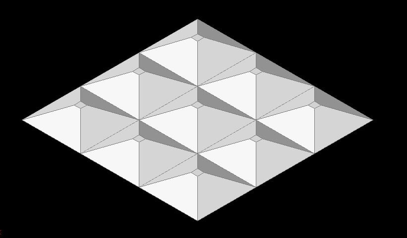

Yeah, a lot of what you find on Youtube is garbage, and those tutorials where they play loud music are really annoying. The grayscale is actually the opposite of what you said though. Black recedes and White protrudes. In the image below you can see how the pyramids would rise up from the black.

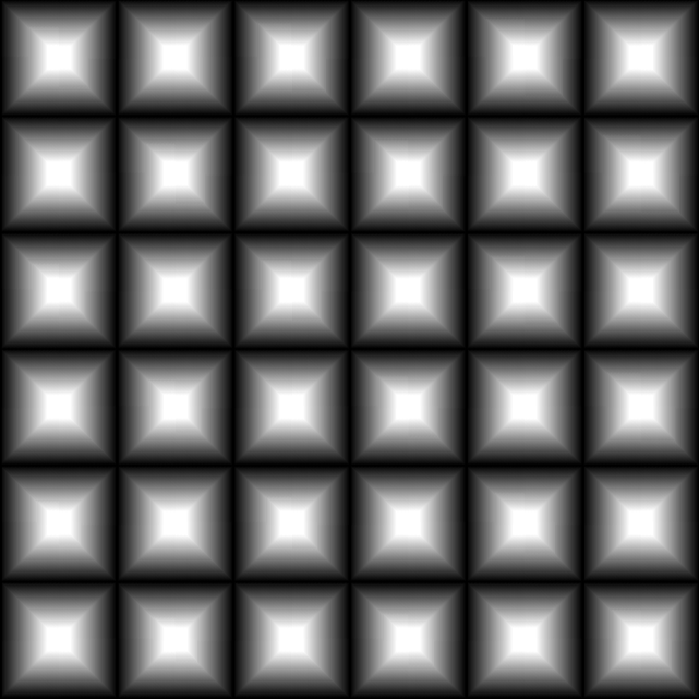

WOW! Cad64 that's almost what I would need except it would be in a straight line pattern like this.
They're .281 square and .125 tall (Roughly) and a 1/32 flat on the top.

I just did a quick internet image search and found that one. Type "knurl pattern bump map" into your favorite search engine and check the image results.

I'm trying to make a bump map from scratch but as I said not to many tutorials out there that start from scratch. The video you posted did explain some of what I needed but he started with a picture of wood. Maybe I'm putting to much into this? I'm so use to having snap and ortho I can't function in PaintShop with out it so I can't make one there. Maybe I shouldn't care so much but I want the knurls exactly .281 base X .125 high with that 1/32" flat on the top. I found a square knurl pattern like you posted going in the right direction so now I'm reading up on how to apply it to an object in a drawing. If I make it I don't know if I need to make just one knurl and that's enough to do the job or not? Most tutorials I see have a row of them. The AutoCad tutorials say you apply the bump map when your making the material but I haven't got around to depth and size. The drawing I posted of the knurls would be great if I could only figure where it knows depth or if that matters.
A bump map is just a fake representation of depth. It's basically a black & white version of your color texture that the program uses to trick your eye into thinking there is detail where there isn't any. The bump map doesn't generate height, like a displacement map, so worrying about the .125 height isn't worth your time because there won't be any height. I also wouldn't worry about trying to get that exact .281 base width either. Just apply the bump map to your model and then adjust the scaling until it looks somewhat correct.

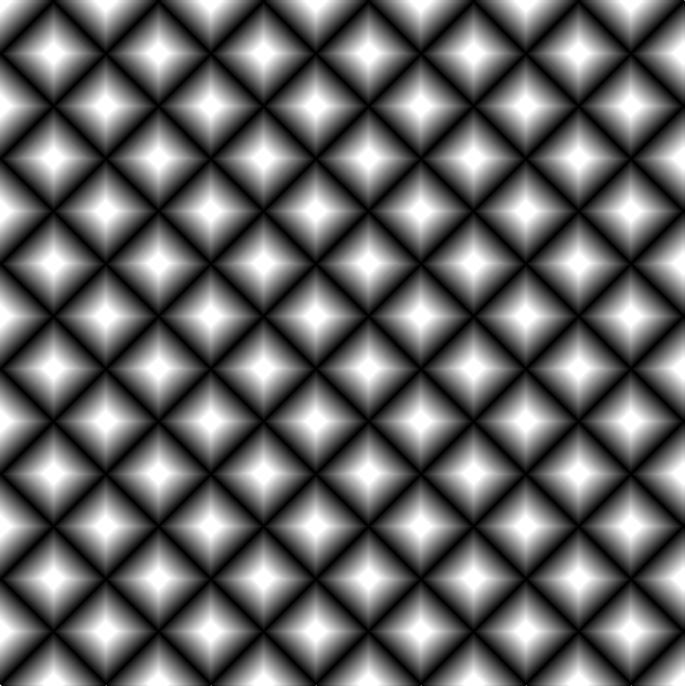

Here's that map I posted yesterday. I took it into Photoshop, rotated it and cropped it so it will tile correctly. Maybe you can use it, maybe not?
