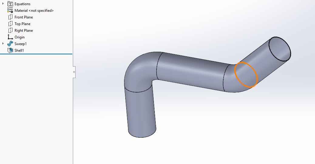

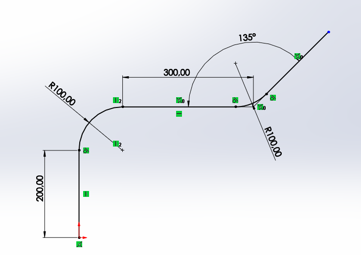

I will use different approach.
First draw center line axis for pipe (do not use construction lines because Sweep wont work).
And with Sweep + Shell u can do the rest.
EDIT: U can use Weldments as well.
