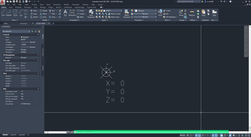

I face the same problem every time I export the data from Excel to AutoCAD which is a point exported on location X:0.00 , Y:0.00 , Z:0.00 I don't know why it exports a point in that location ?!
Can someone please help me?
This is the code :

Hi @Kalsefar
what's the behavior if you ask to draw a line on Autocad area starting from 0,0 ? did you try ? just to check where are your 0,0 coords.
You can do this before running your code in order to understand if the issue it's on the drawing or in your code.
Reading your code Autocad could be open before or after running the excel procedure, so you can open Autocad, new drawing (or existing if required) and trace a line from 0,0 coordinates.
Your code, It's too complex to test only you know what the final scope.
Let us know

From where do you run this code, from Ecel or Autocad?
You can put break point(s) in your code, try in Dick: (😳) place, check what Range("START_1").Offset(i, 0).Value returns.
Another thing, attach Excel file so if anyone want's to try your code...
