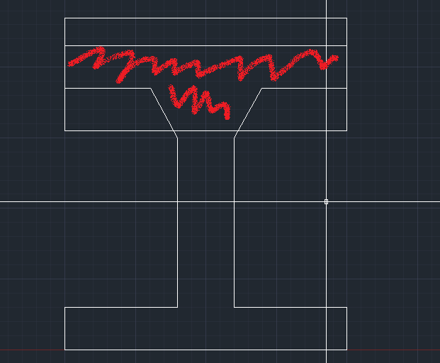

(COMMAND "-BOUNDARY" '((+ (CAR startPoint) (/ width 2.0)) (- (CADR rectEnd)  100.5)) "")
I'm trying to create a polyline from the intersection of a region and a closed polyline.
From other posts I've seen that the -BOUNDARY function can be used to do this, I've also tried to use the "INTERSECT" boolean function but to no avail.
When using the function manually in AutoCAD 2011 I can simply choose a point that lies in the area I want and then press enter to create the desired closed polyline
I get no errors but the function doesnt complete.
I've provided the line in question above and also my full code:

Your structure of the list is the culprit and not the boundary command. ;)
I did not get through you codes but I am correcting the statement that you alluded to.
(COMMAND "-BOUNDARY" (list (+ (CAR startPoint) (/ width 2.0)) (- (CADR rectEnd)  100.5)) "")

Thanks Tharwat!,
it now seems to have a new problem, this is the console output:
Command: -BOUNDARY
Specify internal point or [Advanced options]: Selecting everything...
Selecting everything visible...
Analyzing the selected data...
Point is directly on an object.
I've double checked the point's coordinates and I'm sure it lies within the area I am after and not on one of the edges.
Any clues?

I've fixed it, It's now working, the problem was with the areas not being within the viewport.
 (vla-zoomcenter (vlax-get-acad-object) (vlax-3d-point (3DPOINT)) (getvar 'viewsize))
was the fix,
It moves the viewport so that it's centred on the point 3DPOINT
Thanks again!

Yes that has to be visualized on the screen to let the command creates the boundary.
But I don't think that your addition with the zoom function is correct and it has a variable that is not assigned yet into your routine and extra arguments for sure. ;)
