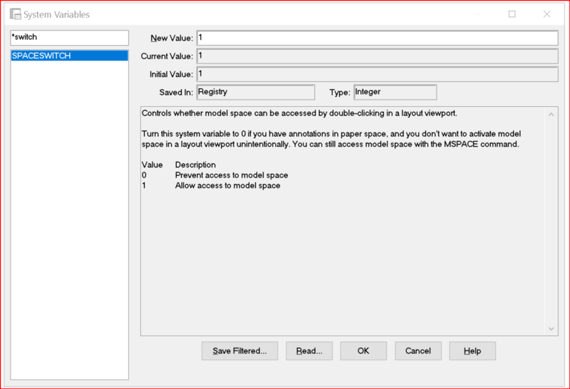

You might want to check your SPACESWITCH variable, as shown in the screenshot from the SYSVDLG box.
The OOTB default value is   <1> maybe a coworker is messing with your ride and changed it to <0>?  Hope not, but worth checking.   :|

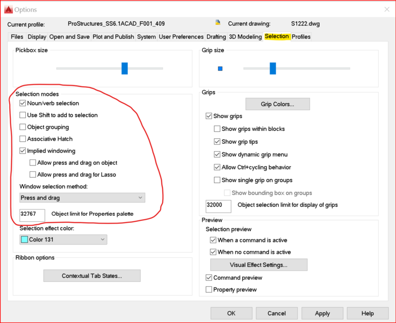

You should check your settings  in OPTIONS on the SELECTION tab too.
Edited by Dadgad
Screenshot added.
Try SELECTIONAREA and/or PREVIEWFILTER if nothing else works. Or in Options-Selection as shown by Dadgad go to the "Visual Effects Settings...".
