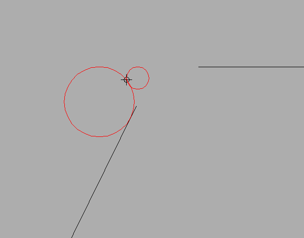

Is it assumed they specified point is on a curve that can even be tangent to the two lines? For instance, the point shown in the attached image cannot exists on a curve that is tangent to the two lines.
If I understand your goal you want to create a fillet between 2 straight lines such that the fillet arc passes through a specified point "p" that is not on either of the two lines. The radius "r" of the arc is unknown.
If so, you can draw the angle bisector to the two lines. There are actually two angle bisectors but we can assume the one to use is implied by the bounds of the lines. The center of the fillet is on this line but where? We know that arc center is a distance r from either line (measured perpendicular to the line) and from the point p.
You can guess a point p1 on the angle bisector and then determine r and the distance s (the distance from p1 to p). If s is less than r determine a new point p2 further out from the intersection of the two lines. and recalculate r and s. Repeat until r and s are equal within a given tolerance.  You can modify the guessing process to speed convergence to a solution.

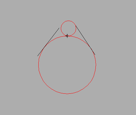

As the chosen point is by the user, it would seem unlikely that it would be impossible!!!
You could get a GIGO solution

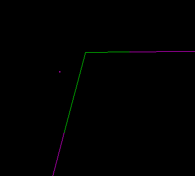

So this is what I came up with so far:

If you choose a point on the circle outside of the lines it will fillet them but the radius is 'off'. I'll probably accept that happens.
