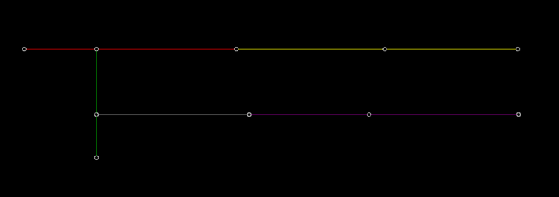

Circles at the end of lines and trim around
teknomatika
As a challenge and variant, it also meets my tasks,
as an alternative to the trim I would serve the break option
at the points defined by the centers of the circles 🙂

when running your version , draws the circles but returns an error.
Error: AutoCAD.Application: Incorrect number of elements in SafeArray
Looking closer at your example, I see you have lines partially overlapping one another. Is this correct?
I'm sure this is what is causing the error, as I did not realize this was a circumstance.
2 minutes ago, teknomatika said:
@alanjt
Yes. I have lines partially overlapping.
In a way this is a recurring situation in my task.
So, the end result can yield lines of two different colors, on the same layer, and the same length atop one another?
@Alanjt Yes. On same or diferent layers and same or diferente length. 🙂
As I said above, for what I need, if possible it also solves an option where the lines are broken (break) at the points defined by the centers of the circles.

@ronjonp I understand  your tip, but in case I really need to break the lines. But the option of breaking the lines by the end points of the lines overlapping them serves my purposes. I even recognize that this alternative will be more advantageous.
Like ronjonp reminded me this was an answer for another post some years ago the advantage is that the length of the lines is to the centre of the circles and not the shortened length.
If all lines are meeting at end points can get every start end point in a list, sort and delete duplicates so only 1 circle is drawn.
circle - donut.lsp:(c-donut).lsp:; circle to donut by Homer simson who loves donuts 😛
Edited by BIGAL
@BIGAL You have a good memory. In fact, at the time, I sought help for this demand. In reality, I continue to look for an efficient routine that in all situations of overlapping lines they are broken at the end points.
The option to insert circles and trim could be one of them, but I admit it will be more efficient with the break use.

@Trudy Thanks for the interest, help and effort.
I tested it and the principle I want is this.
However, I see that the break does not occur at all endpoints.
Attached file to better understand.
Edition: Already after the first test, I see that by repeating the procedure on the unbroken lines in the first phase, they are resolved.
cadtutor_09102020_test.dwg
Edited by teknomatika
I see the problem teknomatika but in this moment dont know how change the code if someone elese can change i will be glad.
Solution for now to run the routine several times, because with one routine break the lines one time only.

@Trudy,
Thank you very much. As it is, it is a precious help.
As for the number of overlapping lines, at least two. That is, as a rule I have a set of lines that should be overlapped on another set. Then enter the routine to detect those overlapping lines and make the break. Then, with another routine, the duplicated and overlapping lines are checked and the respective differentiation carried out using different colors and layers.
Update: In the meantime, in certain situations, I find that the routine does not act. What will be the problem? Apparently the lines in question have the same delta Y.
Attached file with the reported situation.
CADTUTOR_TEST_09102020_2.dwg

Hello, teknomatika  i modify a lot the cod and think this may work :D

The lisp is not very fast but that is for now :D
@Trudy
Once again I want to thank you for your help, interest and effort.
I tested the new version and for now it seems to work very well. Good job.
As for the previous question: Yes, the overlapping lines can be in different layers and in different colors and in different styles.
Not wanting to abuse your help, and being already a refinement, it would be interesting that the new lines created by the action of the routine, can be allocated in a specific layer, for example, identified as duplicate lines. 🙂
Thanks!

;select all in new Trudy_ layer
;move to duplicate layer
  (if (setq ss (ssget "_X" '((-4 . "<or")(8 . "Trudy_*")(-4 . "or>"))))
        (setq li (ssname ss (setq i (1- i))))
        (setq lil (cons (list (cdr (assoc 10 (entget li))) (cdr (assoc 11 (entget li))) li) lil))
      (foreach li lil
        (if (vl-some '(lambda ( x ) (or (and (equal (car li) (car x) 1e-6) (equal (cadr li) (cadr x) 1e-6)) (and (equal (car li) (cadr x) 1e-6) (equal (cadr li) (car x) 1e-6)))) (vl-remove li lil))
          (setq dellst (cons (caddr li) dellst))
  (setq brr (length dellst))
  (princ brr)
  	(repeat (length dellst)
		;(setq nam (ssname ss (setq i (1- i))))
		(setq ent (entget (car dellst)))
		;(princ ent)
		(setq lay2 (subst (cons 8 (strcat "duplicate_lines" )) (assoc 8 ent) ent))
		(entmod lay2)
		(setq dellst (cdr dellst))
;move all to old layer
(setq sel3 (ssget "_X" '((-4 . "<or")(8 . "Trudy_*")(-4 . "or>"))))
	(repeat (setq i (sslength sel3))
		(setq nam (ssname sel3 (setq i (1- i))))
		(setq ent (entget nam))
		(setq lay2 (subst (cons 8 (substr (cdr (assoc 8 ent)) 7)) (assoc 8 ent) ent))
		(entmod lay2)
;delete all Trudy_ layers
(while (setq a (tblnext "LAYER" (null a)))
			(setq emplay (cons (cdr (assoc 2 a)) emplay))
;(princ emplay)
(foreach y emplay (if (wcmatch y "Trudy_*") (command "laydel" "N" y "" "Y")))
(princ (strcat "\n" "Select" " " (rtos (sslength sel1) 2 0) " " "lines"))
(princ (strcat "\n" "Found" " " (rtos (length list4) 2 0) " " "non duplicate points"))
(princ (strcat "\n" "Repeat" " " "breaking" " " (rtos (- (car br) 2) 2 0) " " "times"))
(princ (strcat "\n" "Result" " " "is" " " (rtos (sslength sel3) 2 0) " " "new lines"))
(princ (strcat "\n" "Duplicate lines are" " " (rtos (/ brr 2) 2 0)))
Duplicated part is from.
https://www.cadtutor.net/forum/topic/33136-help-select-duplicate-entities/page/4/#comments
marko_ribar
Edited by Trudy
@Trudy Good job. Much better.
It is a fact that with many entities it becomes a little slow, but it solves many of the situations that I face in my work.
For any improvement or change, I will ask again in the hope that you can help. 🙂
