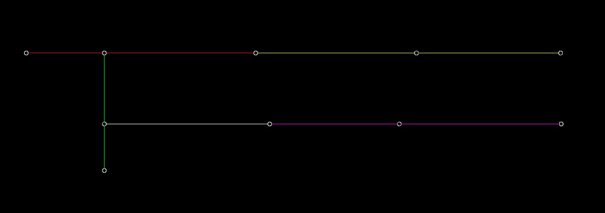

Trudy Posted October 7, 2020 Share Posted October 7, 2020 Hello, teknomatika This is result when i start the lisp.  Quote Link to comment Share on other sites More sharing options...

teknomatika Posted October 7, 2020 Author Share Posted October 7, 2020 24 minutes ago, Trudy said: Hello, teknomatika Which lisp do you use only my or this where is modify from Alanh. (try with my lisp)  Trudy, I went back to testing and in fact it didn't happen. However, I see that when circles overlap, they are also affected by trim. Although as it is already satisfying what I want, it would be interesting that the circles were preserved without trim.  Thanks for help!    Quote Link to comment Share on other sites More sharing options...
