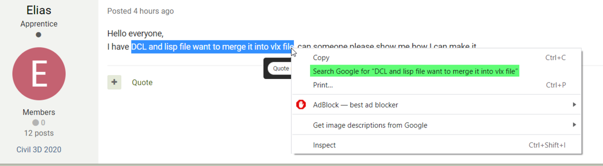

ronjonp Posted September 30, 2020 Posted September 30, 2020 On 9/30/2020 at 10:45 AM, Elias said: Hello everyone, I have DCL and lisp file want to merge it into vlx file, can someone please show me how I can make it. Expand Quite a few answers on the web already: 1 1 Quote
Steven P Posted September 30, 2020 Posted September 30, 2020 I didn't know you could do that with a right click ronjon, never looked for that either though 1 Quote
Elias Posted September 30, 2020 Author Posted September 30, 2020 Serious Bro, @ronjonp Doesn't help Quote
BIGAL Posted September 30, 2020 Posted September 30, 2020 (edited) "Make vlx autocad" 1st google suggestion has answer Edited September 30, 2020 by BIGAL Quote
ronjonp Posted October 1, 2020 Posted October 1, 2020 (edited) On 9/30/2020 at 10:07 PM, Elias said: Serious Bro, @ronjonp Doesn't help Expand It took me less than 30 seconds to find what you're looking for? Better yet learn how to write the DCL files on the fly then you don't need to include anything Edited October 1, 2020 by ronjonp Quote

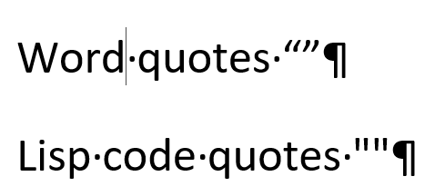

BIGAL Posted October 3, 2020 Posted October 3, 2020 Nice rlx and grr maybe takes me 4 replaces to do in Word and Notepad sure could do somehow in Notepad++ will have a look for ^p open dcl in Word Replace ^p " fo)^p all Replace " \" all Replace ^p ^p(write-line " all Ctrl+c the " in notepad Replace, paste the " with " all the two " are different. (write-line "dd4x3: dialog { " fo) (write-line "label = \”Please choose item\”; " fo) (write-line " : column { " fo) (write-line " : row { " fo) Quote

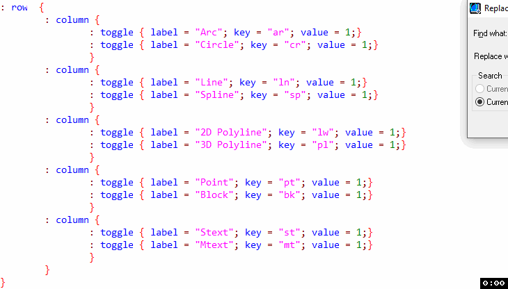

Tharwat Posted October 3, 2020 Posted October 3, 2020 On 10/3/2020 at 8:26 AM, BIGAL said: open dcl in Word Replace ^p " fo)^p all Replace " \" all Replace ^p ^p(write-line " all Ctrl+c the " in notepad Replace, paste the " with " all the two " are different. Expand You don't need to open the dcl file in other than Vslide and here is a very simple example with the use of Replacement dialog and its a matter of 2 seconds. Quote
