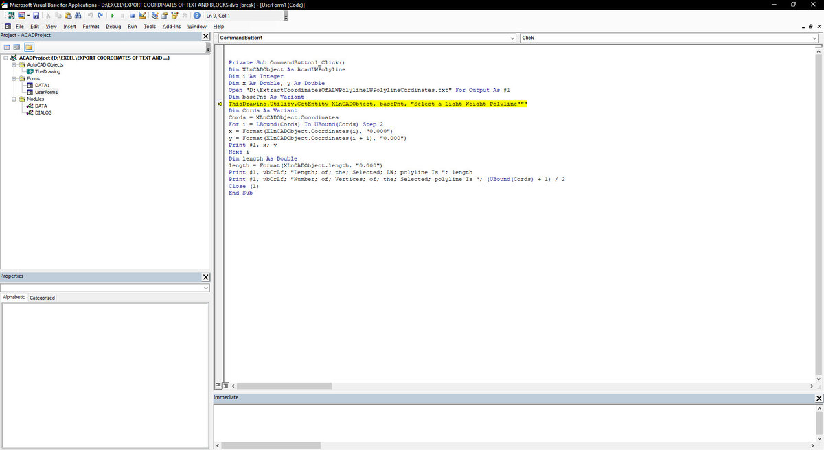

Hi there,

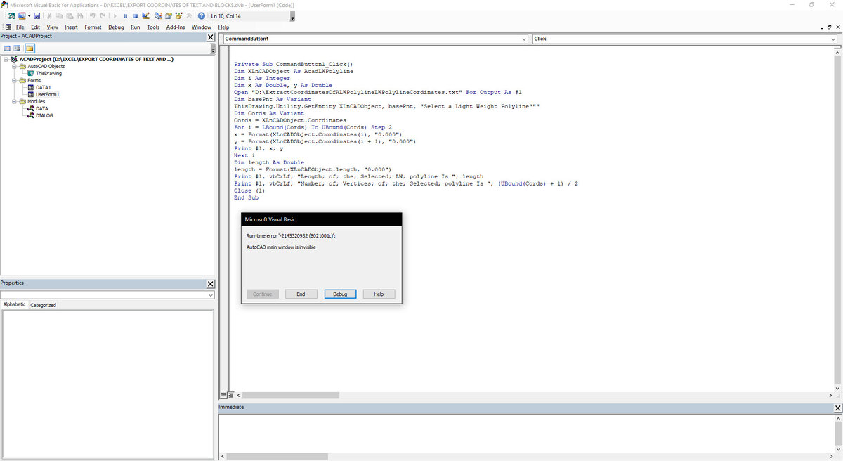

I find the code that can help me to select an object from Model Space but it gives me an error I tried to solve it but I failed can you please help me.
Kindly find the attached pictures to be more clear.
Code:
Private Sub CommandButton1_Click()
Dim CADObject As AcadLWPolyline
Dim i As Integer
Dim x As Double, y As Double
Open "D:\ExtractCoordinatesOfALWPolylineLWPolylineCordinates.txt" For Output As #1
Dim basePnt As Variant
ThisDrawing.Utility.GetEntity CADObject, basePnt, "Select a Light Weight Polyline"""
Dim Cords As Variant
Cords = CADObject.Coordinates
For i = LBound(Cords) To UBound(Cords) Step 2
x = Format(CADObject.Coordinates(i), "0.000")
y = Format(CADObject.Coordinates(i + 1), "0.000")
Print #1, x; y
Next i
Dim length As Double
length = Format(CADObject.length, "0.000")
Print #1, vbCrLf; "Length; of; the; Selected; LW; polyline Is "; length
Print #1, vbCrLf; "Number; of; Vertices; of; the; Selected; polyline Is "; (UBound(Cords) + 1) / 2
Close (1)
End Sub

Maybe look carefully at this line what is extra ?
