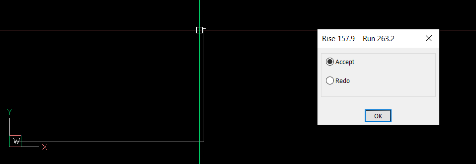

BIGAL Posted September 30, 2020 Posted September 30, 2020 A couple of comments if the dwg is architectural and is in mm then rtos would always be 2 0 for lengths etc notice still a few rtos 4 4 ? Why convert ft to mm (rtos (* ftf_n 0.0254) 2 4) work in mm totally. Lastly stairs do not have fixed height tread & width rather they must meet a code of practice that takes into account rise run ratios did not see that obviously in the code, happy to be told I am wrong. With say a fixed start and top point often stairs will fail the code check so the designer must look at what to change. Quote
pkenewell Posted October 1, 2020 Posted October 1, 2020 (edited) @BIGAL I appreciate your comments. I don't pretend to know Architectural codes and the rules for stairs. I was just trying to accommodate prodromosm in his original post that the program was working for him, but he just needed to convert from Feet to Meters. In my tests - the conversion factors seemed to work when the sample drawing was scaled for Meters. Note: If he was wanting to work in Meters, then the sample drawing was incorrect being in Architectural units which are made for Imperial measurements. Please correct me if I am wrong, but Meters should be expressed in decimal units with the MEASUREMENT system variable set to 1 for Metric. The only time I use (rtos nnn 4 4) is on the text output, where I expressed the total height using dual units. Not necessary just a convenience so I could see the program was converting correctly. On the area where i am using (rtos (* ftf_n 0.0254) 2 4) is converting INCHES to Meters. Because if you are working in Feet in architectural units, in decimal terms you are really working in Inches (per the sample drawing & the default values in the original program). As you said - The OP should be able to figure out how to adjust the program now for his needs. However - If you have any insights in how to make the program work better - feel free to contribute them. Edited October 1, 2020 by pkenewell Quote
BIGAL Posted October 1, 2020 Posted October 1, 2020 I avoided editing it as I have a stair routine its part of a package, working in metric is so much easier you do not do any converting hence 25.4mm is not needed set the units correct to start is most important as you say. If its just a tread height / run then its a simple zig zag pline For AUS, AS1657 2018 section 4 Stairways you have to pay to get the std. This is an example https://stepform.com.au/as1675-2018/stairs-detail.html Quote
