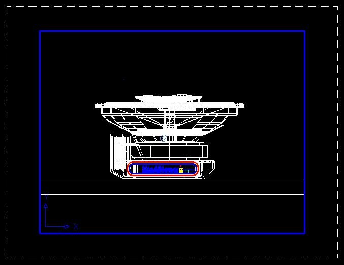

And yes, that image I posted with the 3 viewports is in a paper space layout, not model space. I simply created 3 viewports and set the view and the scale for each viewport accordingly. I know you can set up viewports in model space too, but I have no idea how printing works. I think the last time I printed from model space was probably over 30 years ago. :beard:

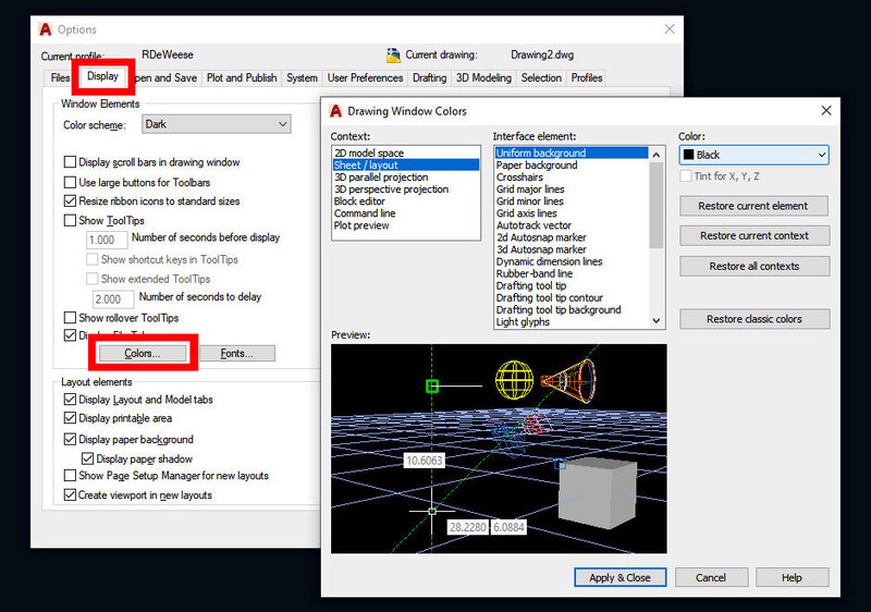

Why is your paperspace a black background and mine white.

My paper space background is black because I changed it. I spend the majority of my day working in the layout tabs and I can't stand staring at a white background. If you want to change your background color, type OPTIONS at the command line, then go to "Display" and then "Colors". Then you can change the Sheet/Layout - Uniform Background color to black.

Paperspace viewports are different to model space viewports. (I've never found a need for modelspace viewports myself).
Taking your post above where you show a paperspace viewport, with a small view of the modelspace.
Double click anywhere inside that viewport and it becomes 'Active'.
You can then zoom, pan, etc, to fit whatever part of model space you want to see in that viewport.
(So in that one above you could zoom so the little modelspace view fills the whole paperspace viewport).
Normally you would zoom to a particular scale, but you don't have to.
Once you have it showing what you want the double click anywhere outside the viewport to 'de-activate' it.
You can have multiple paperspace viewports in one layout, all with their own view settings, you can resize them, move them about, and so on.
Or you can have multiple layouts each with a different view of the model space.

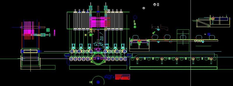

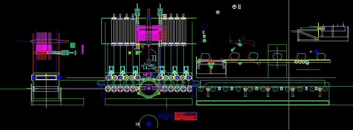

Here's a Gang and infeed I was working on a long time ago. I designed a shifting locking/clamping system. At the time of this all clamping was done on the inside of the Gang and all shifting was done on the outside. The water would eventually start rusting the chromed parts on the inside. So I made it all outside.
Just to keep it honest that wasn't the idea that was used, I designed a saw guide milling machine, it cuts babbitt off the saw guides
See I even have a title block.

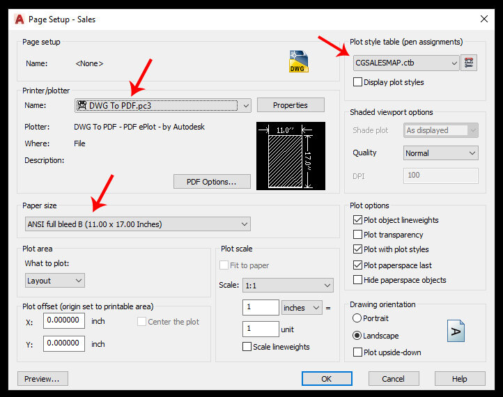

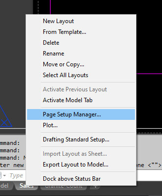

Right click on the Layout tab at the bottom of your screen and then choose "Page Setup" from the pop up menu. Or type PAGESETUP from the command prompt. This will open a dialog where you can choose which layout you want to set up, so choose the one you want to work on and then click the "Modify" button. This will open the Page Setup manager for the Layout. This is where you choose your Printer/Plotter, Plot Style, Paper Size, Etc. When you're done, click OK.

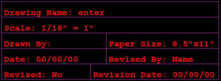

Yeah but mine doesn't have a title block (I think that's what it's called). The square thing in the right bottom corner where you place the information about the drawing. Like who drew it, date, drawing number etc.
Where do add or change that. Is there a standard I need to be aware of.
Here's one I made way back in the early 2000's. But I don't think you could consider it standard
Edited by Berzerker
Dont worry about a title block just draw a rectang the size of your printed sheet if 11x7 etc you need it to be a little smaller as you need a printer margin say 1/4" all round you may have to experiment a little depens on printer.
Put the lower left at 0,0 makes life easier, then make a viewport or viewports inside this rectang do say zoom e as 1st go, set scale of viewport, go to print/plot set up all your settings, plot extents, at 1:1, centered can check by preview if happy click apply then print. Once you apply you can click on cancel as well it will remember your print settings.
In a new dwg you can steal these plot settings but its easier to save the plot settings in a dwt your blank template dwg.

While I'm learning I might as well learn it all.

Got quite a few questions on this. To start I open a drawing which will be drawing1 as always. Ok I get the border part about drawing a square a little smaller than the print area. But reading on the web it says: "Set the current layer to a layer that's reserved for layout viewports (recommended)." which ones are those? Or do I select a layer color I want and name it like "Layout"
Now I would go to page setup, select new, name it and change all the plot settings and click OK when done. Now save it as a .dwt in a folder or should I do this first. I always name a drawing first I never draw in drawing1, learnt that was bad a long time ago. Then you read on and it says just copy and paste your title block into it through the clipboard with the "Copy with base point" to paste it in the layout template.

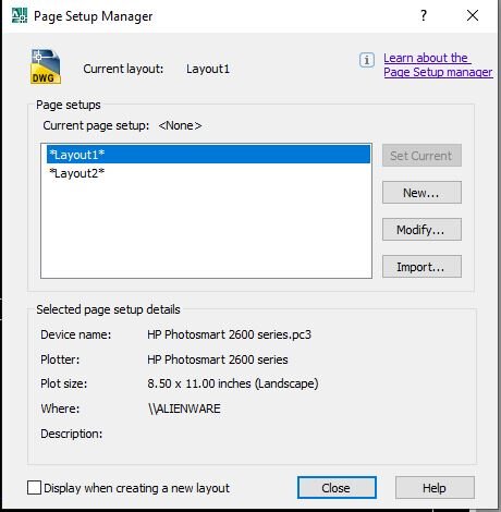

I finally see where I was not getting it. All this Time I took "Layout1" and "Layout2" as just plan settings of the drawing. I've seen that a lot before but never payed it that much attention.
You edit "Layout1" when your in "Layout1". I can modify it from here:
While in "Layout1" I can select inside and modify border colors, that dotted outline of the printer area or anything I want!

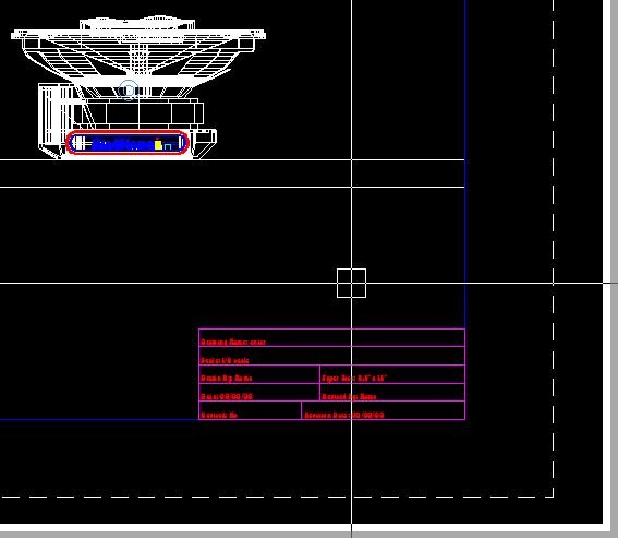

Just to see what it would do I placed the Title block I found in it and got this:
Now when I want to print I just click this tab and hit print and it's all set up? I can zoom and move everything  into the field of view and that's what I'll get?
Edited by Berzerker

I see where saving the TitleBlock as a block itself would help. When I inserted the TitleBlock in it changed the font settings.
