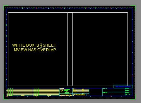

If your limited to 8.5x11 but want bigger  there is "Tile" lisp out there but much easier is use a layout with a mview set a rectang to sheet size less margins and a mview at correct scale 1:1 etc do a print then move the rectang and mview a 1/2 sheet to the other side, print get the sticky tape out and you have a bigger sheet. Once you set the print settings click on Apply this will reset the print area to black and you can print again as it remembers the settings.

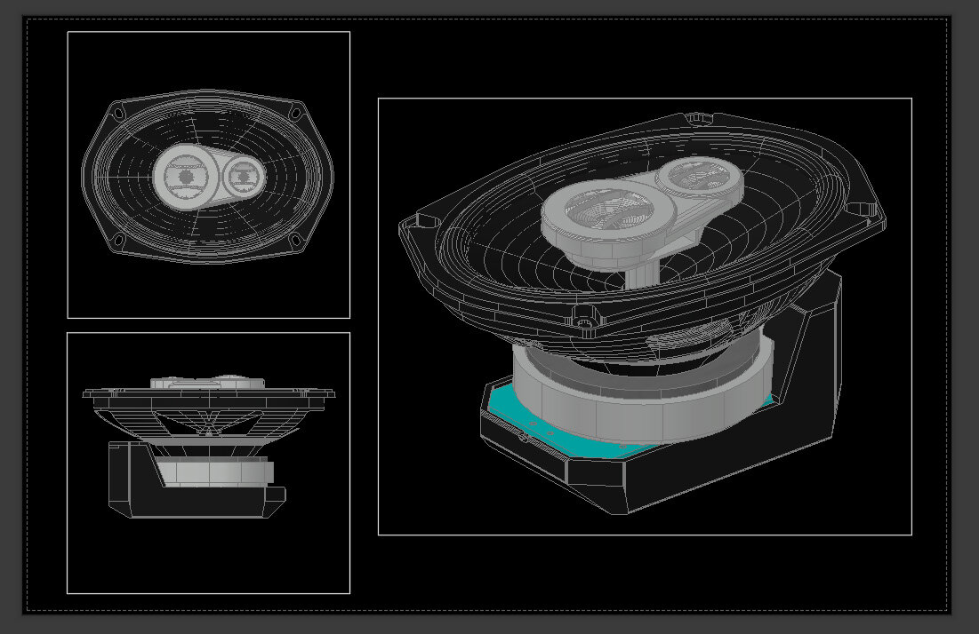

Yes, you can create several viewports for different views and scales. This is very useful for 3D models when you want to show the side, top and 3/4 view. Just set up some viewports. You can also set the shademode in each viewport, in case you want one to be wireframe or conceptual or realistic or whatever.
Here's your speaker set up with the top and side view at 1:2 scale and a 3/4 view at 1:1 scale on an 11x17 sheet.

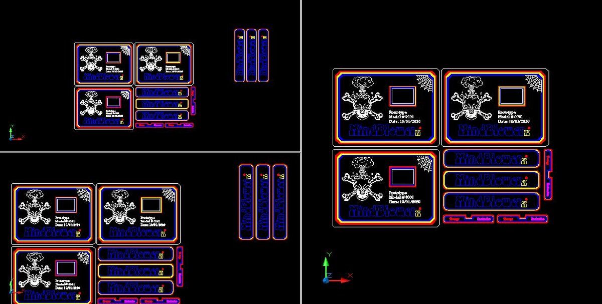

But aren't those viewports not paper space views? I know you can set up viewports in model space.
I can set three view in my window:

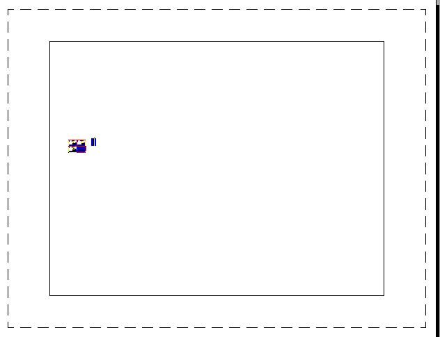

But if I click on paper I get this. It's not three different views, it's one and I'd need to set scale.
And it's the same view no matter what viewport I click on and click paperspace.
