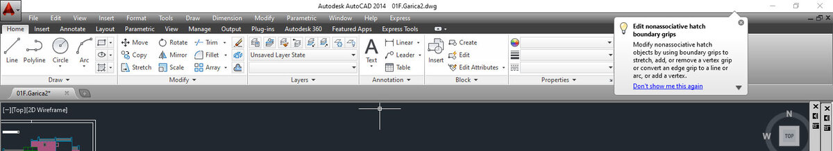

Butch Posted September 28, 2020 Share Posted September 28, 2020 (edited) Please see the image attached. I instaled windows10 on my computer. There seems to be a issue with y Autocad 2014 couse I dont see the top Quick access toolbar with all the icons When I click on the white bar, it behaves like all the icons are there, but the are not visible. How to change this? How to make them visible? Edited September 28, 2020 by Butch Quote Link to comment Share on other sites More sharing options...
Dadgad Posted September 28, 2020 Share Posted September 28, 2020 Try right clicking in that white area. Quote Link to comment Share on other sites More sharing options...

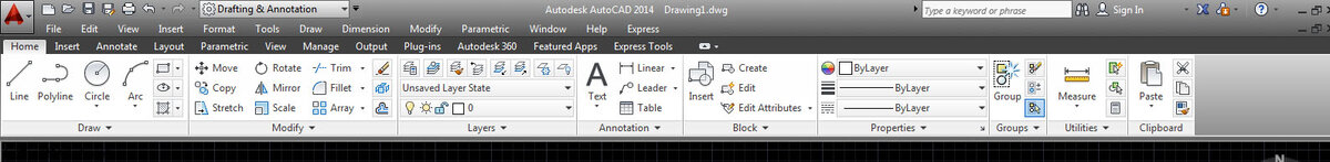

Butch Posted September 29, 2020 Author Share Posted September 29, 2020 (edited) Heres a screenshot of same autocad version but on Windows 7. See the difference. ....i think this has to do something with windows 10 themes....but I dont know how to change it.... Please help Edited September 29, 2020 by Butch Quote Link to comment Share on other sites More sharing options...
Dadgad Posted September 29, 2020 Share Posted September 29, 2020 Sorry Butch, I don't know what to tell you. I run Autocad 2016 on Windows 10, and it works OK, displays properly with Quick Access Toolbar. Try checking in your OPTIONS, on the PROFILE tab, and make sure that the Profile you favor is in use? 1 Quote Link to comment Share on other sites More sharing options...
SLW210 Posted September 29, 2020 Share Posted September 29, 2020 AutoCAD 2014 was pre Windows 10 and not supported. AutoCAD 2016 was the first supported in Windows 10, with an update IIRC. A different Graphics card and/or driver my resolve this problem, but hard to say, but problems with the Ribbon and Quick Access and other similar things seem to be par for the course. You could always just stay on Windows 7 or upgrade AutoCAD. Longbow claims to have a fix as well. 1 1 Quote Link to comment Share on other sites More sharing options...

Butch Posted October 8, 2020 Author Share Posted October 8, 2020 Seems that v.2104 does not like win10. 2016 is working fine Quote Link to comment Share on other sites More sharing options...
