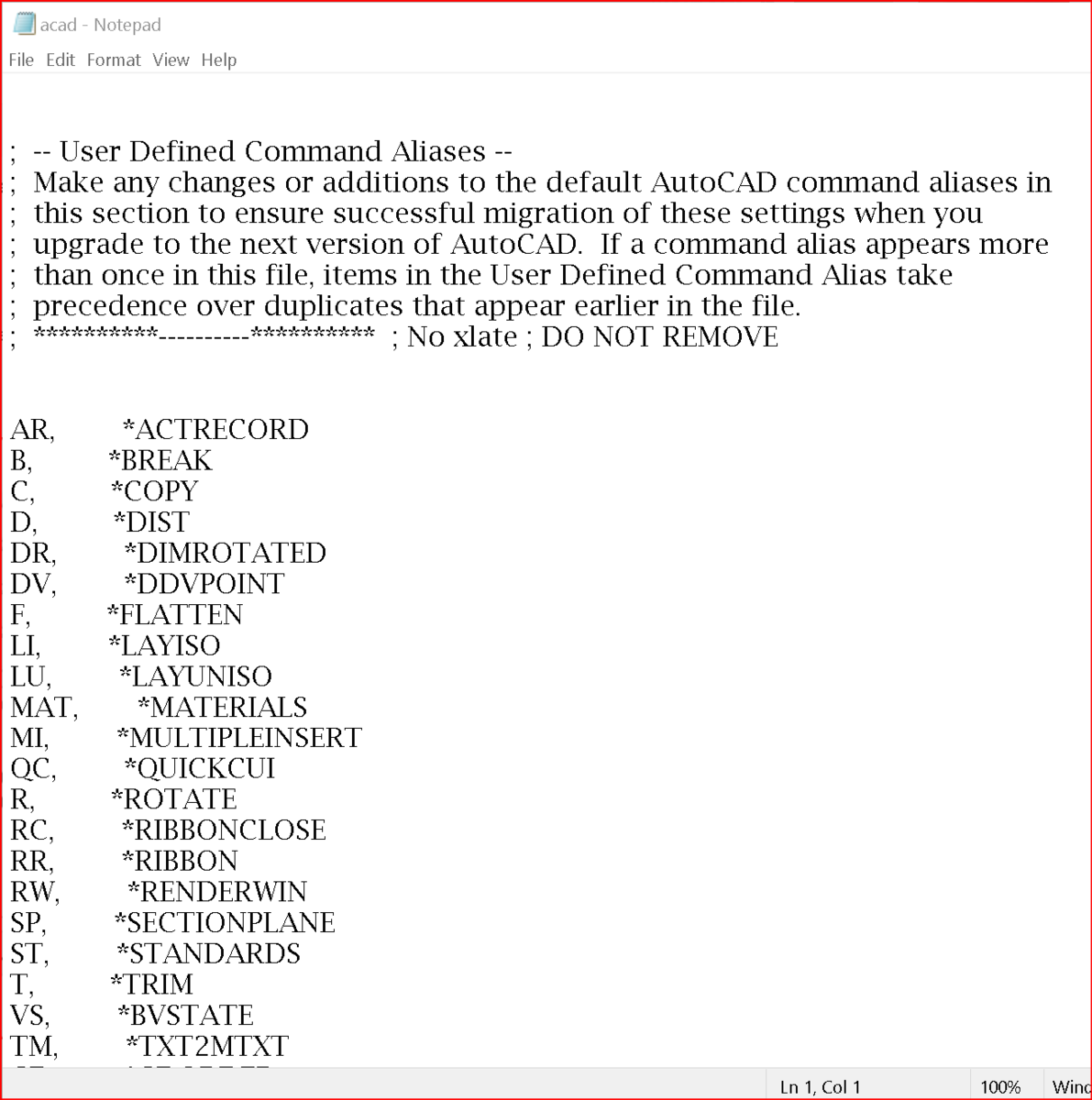

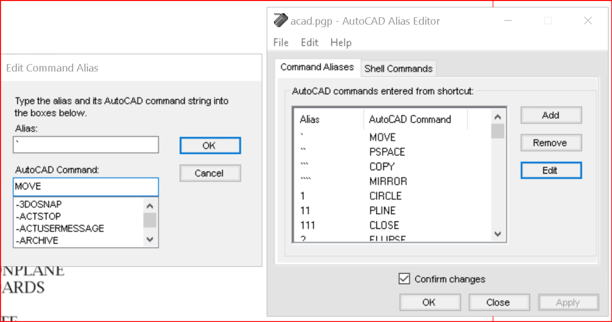

Single key shortcalls are great, with multiple hit variations.
When you use ALIASEDIT to define your personal shortcall preferences they are entered into
the bottom most section of your .PGP.
Once they are there, they will migrate if you go to a newer version.
I trust that you have a SAVED version of your .PGP file somewhere other than
in the software, on a flashdrive or elsewhere on your computer, or in your Email inbox folder.
That makes it easy to share with other team members or friends, and to access
from wherever you are via your email.

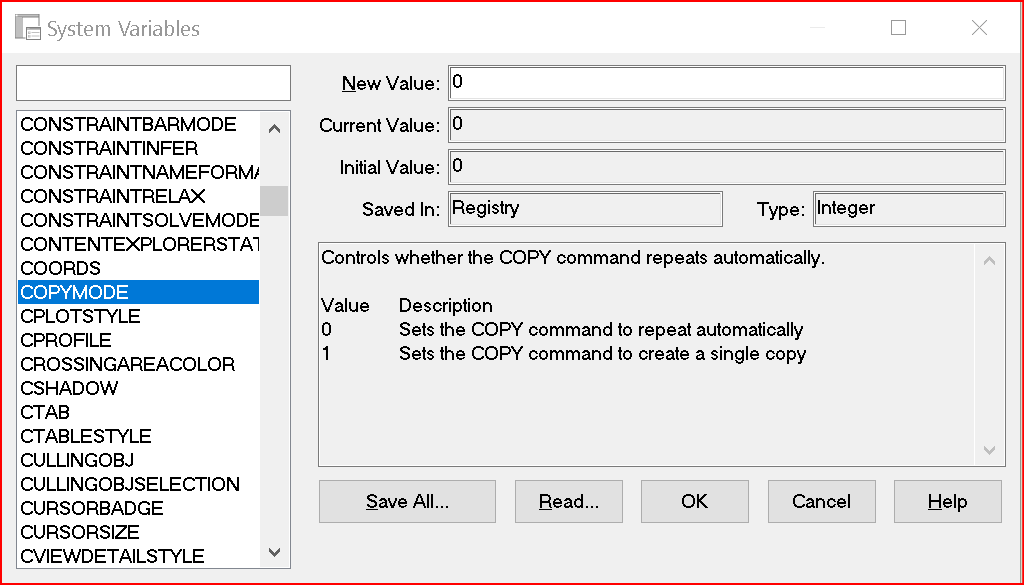

Have to jump on somebody elses rig to do a little work?
MAKE SURE YOU SAVE THEIR CURRENT .pgp before reading yours onto the machine,
in the bottom of the SYSVDLG box.
Once you are through using that machine make sure you switch the .PGP file back to their original one,
which you saved earlier.

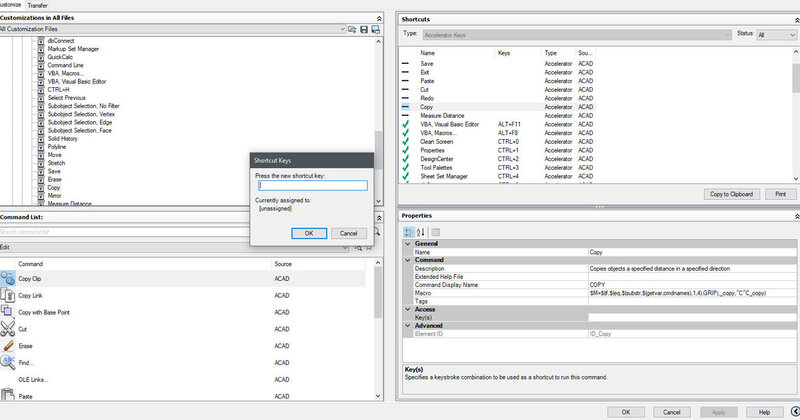

As it so happens, that post with numerous screenshots
also relates to a thread you started back in 2016 about migration of customizations.   :beer:
