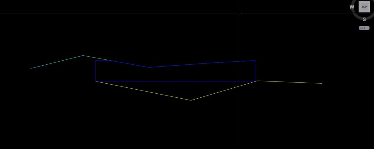

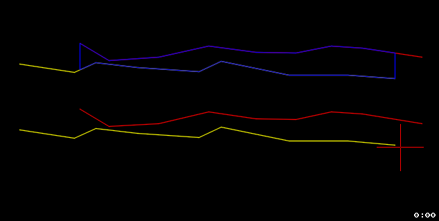

Tomislav Posted September 26, 2020 Share Posted September 26, 2020 (edited) Hello everyone. I tried to do it but simply don't have the knowledge to make it. I'm in need of lisp where I select two polylines and the lisp creates closed polyline on current layer, using those selected and leaving them in drawing. Now the trick is on each side the shorter polyline must cut the longer one or connects to longer one using ortho (it's not perpendicular). And another problem is that there are other lines and polylines crossing those two (cross section). See the image for better understanding. Edited September 26, 2020 by Tomislav added text Quote Link to comment Share on other sites More sharing options...

Tomislav Posted September 29, 2020 Author Share Posted September 29, 2020 (edited) Hello Tharwat, very good lisp but I'm getting this and what about when one poly is longer on both sides? Edited September 29, 2020 by Tomislav Quote Link to comment Share on other sites More sharing options...
Tharwat Posted September 29, 2020 Share Posted September 29, 2020 Alright, this should cover more cases. (defun c:Test (/ p1 p2 p3 ss c1 c2 x1 x2 sp cd) ;; Tharwat - 29.Sep.2020 ;; (and (or (/= 4 (logand 4 (cdr (assoc 70 (entget (tblobjname "LAYER" (getvar 'CLAYER)))) ) ) ) (alert "Current layer is locked!. Unlock then try again.") ) (setq p1 (getpoint "\nSpecify end point of first polyline : ")) (or (setq ss (ssget p1 '((0 . "LWPOLYLINE")))) (alert "No LWpolyline found at that point. Try again.") ) (setq c1 (mid_ ss)) (setq p2 (getcorner "\nSpecify end point of second polyline : " p1)) (or (setq ss (ssget p2 '((0 . "LWPOLYLINE")))) (alert "No LWpolyline found at that point. Try again.") ) (setq c2 (mid_ ss)) (setq cd (vlax-get-acad-object) sp (vla-get-block (vla-get-activelayout (vla-get-ActiveDocument cd)) ) ) (setq x1 (vlax-invoke sp 'Addxline p1 (polar p1 (* pi 0.5) 1.0))) (setq x2 (vlax-invoke sp 'Addxline p2 (polar p2 (* pi 0.5) 1.0))) (progn (vla-ZoomExtents cd) (command "_.-boundary" "_none" (mapcar '(lambda (j k) (/ (+ j k) 2.0)) c1 c2) "" ) (mapcar 'vla-delete (list x1 x2)) (vla-Zoomprevious cd) ) ) (princ) ) (vl-load-com) (defun mid_ (ss / ent len mid) (setq ent (ssname ss 0) len (vlax-curve-getdistatparam ent (vlax-curve-getendparam ent)) mid (vlax-curve-getpointatdist ent (/ len 2.0)) ) mid ) 1 Quote Link to comment Share on other sites More sharing options...
Tomislav Posted September 29, 2020 Author Share Posted September 29, 2020 (edited) well, it does cover this last example, but still there's no solution for one poly being longer on both sides, and it doesn't work with 2dpolylines... my idea is based on that I make xlines on shorter end, get crossing points on longer ends, lose the vertices on longer ends based on those points, add that points to vertex list and then create one poly from all those points... Edited September 29, 2020 by Tomislav Quote Link to comment Share on other sites More sharing options...
