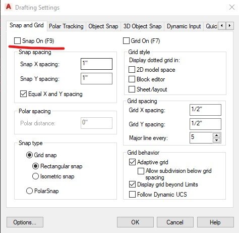

Running Lt2016 for years and have come across problem with CAD program not allowing me to draw a short (less than 1/2") line.  It results in a point, which Properties says is a 0 length line.  Also, and probably related is I cannot resize a polyline rectangle by small increments either.  I select the midpoint of a side and try to drag it over slightly.  Nothing unless I drag it 1/2" increments.  I have no clue as to what setting I have changed.
Sounds more like OSNAP or Snap needing to be off.
F3
Line F8 drag mouse 0.1 0.1 0.1 0.1 etc no problems little blip  zoom E 4 lines.
F3
THIS^^^^^^^ 👍   Hope  that's the Thumbs Up imogi.  Can't see it clearly.  I accidentally flipped my 78 year old cousin Patricia off the other day.  😵😇😁
