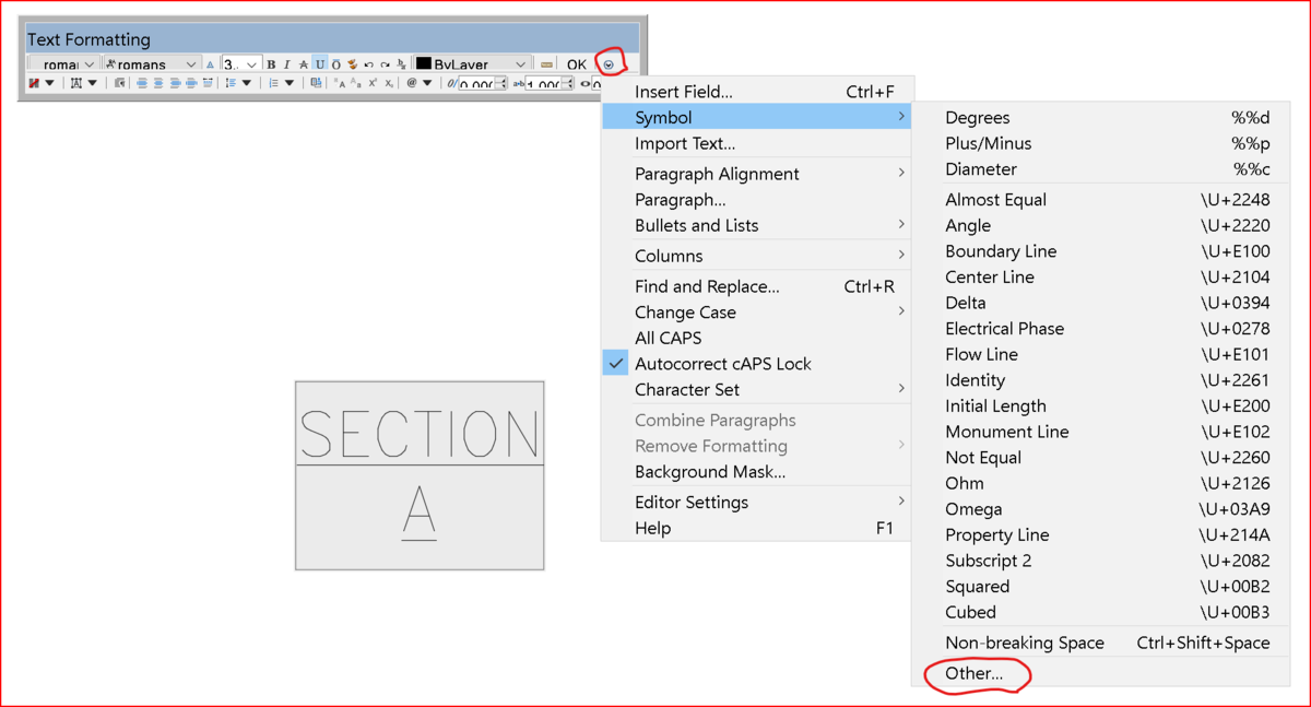

Dadgad Posted September 10, 2020 Share Posted September 10, 2020 @BIGAL and @CAD64 have already sorted you out on this, but an additional easy place to find this on the fly, while working, is at the right end of the TEXT FORMATTING bar, as shown in the screenshot. If you don't find what you want on that quick reference list, just click on OTHER and you will go right down the Global Rabbit Hole into the belly of the beast, as shown in the second screenshot. 1 Quote Link to comment Share on other sites More sharing options...
