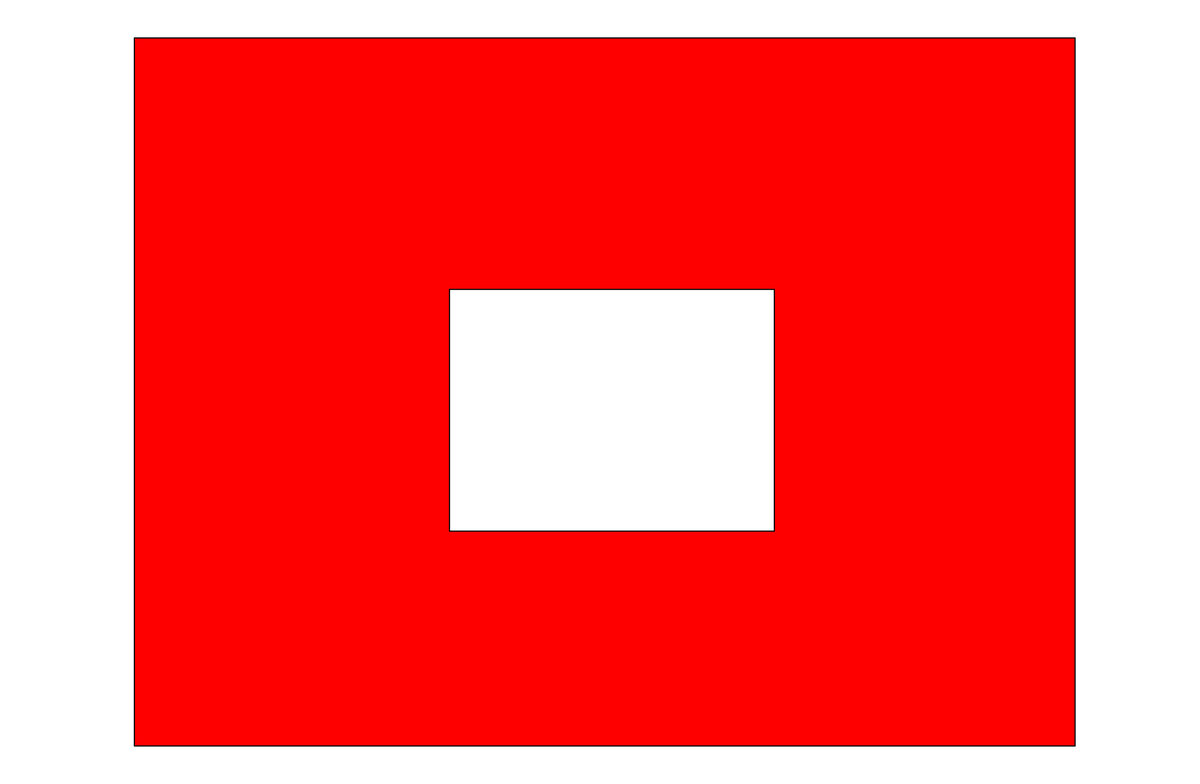

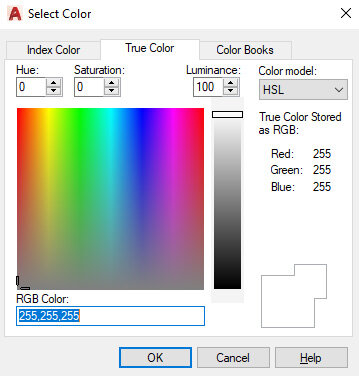

Cad64 Posted September 30, 2020 Share Posted September 30, 2020 Can your printer print white? Try putting your object on its own layer with the layer color set to "True Color" 255,255,255. In the image below, I have 2 solid hatches stacked on top of each other. The smaller hatch has color set to 255 and the larger one is obviously red. I printed this to pdf and it worked. Not sure how it would work on an actual physical printer though. Quote Link to comment Share on other sites More sharing options...
Berzerker Posted September 30, 2020 Author Share Posted September 30, 2020 Thanks Cad64 I got it thanks to your help. "Gotta be smarter than what your working with" Pops always said. Quote Link to comment Share on other sites More sharing options...

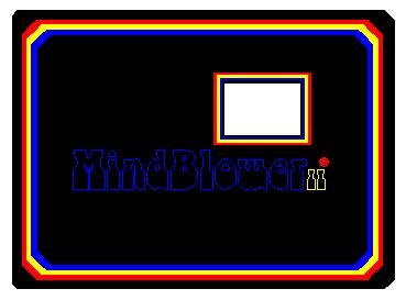

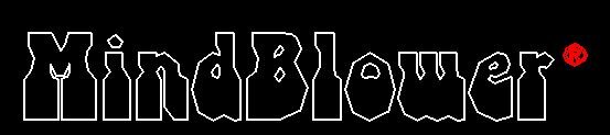

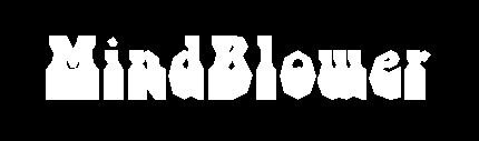

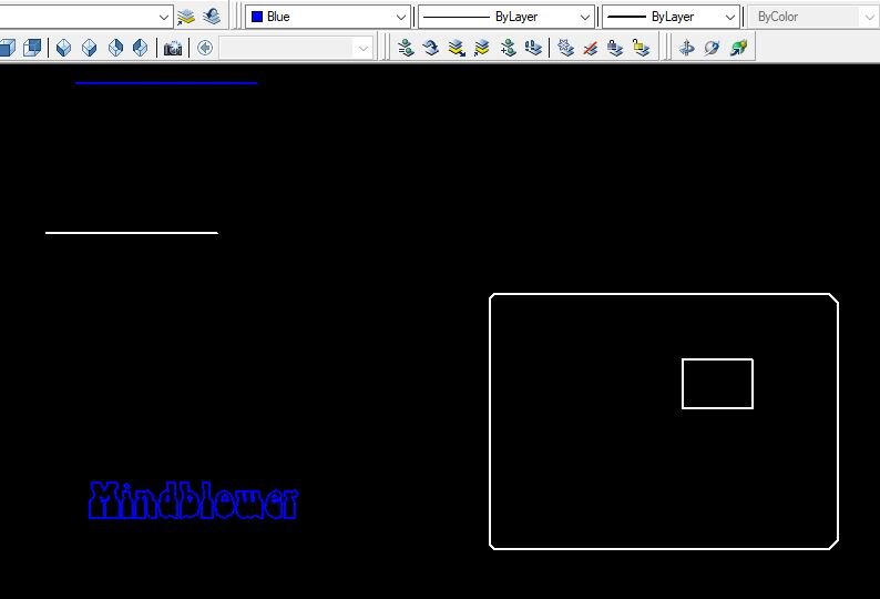

Berzerker Posted September 30, 2020 Author Share Posted September 30, 2020 (edited) OK now I know I've changed something in some kinda text fill setting and I don't know how to change it back. Here it is way back: And here it is now. I knew I changed something to get it solid. I tried to just copy and paste from one drawing to the other but it still tuned solid filled. Edited September 30, 2020 by Berzerker Quote Link to comment Share on other sites More sharing options...
Cad64 Posted September 30, 2020 Share Posted September 30, 2020 Yeah, I remember you mentioned this a few days ago. I checked every setting I could think of, but couldn't figure out how you were able to get the text to display like that. The only way, (that I'm aware of), to get text to outline like that is to use the TXTEXP command to explode the text. But then it's not actually text anymore. It's just polylines. Quote Link to comment Share on other sites More sharing options...
Berzerker Posted September 30, 2020 Author Share Posted September 30, 2020 (edited) I changed a setting somewhere and I can't remember what it was. It's the only drawing I could find like that. So I saved it as another file name and deleted everything in it. Now I have a template to use in that style. Whenever I want to make drawing with that text style I'll just rename it and use it and bingo outline text only. Edited September 30, 2020 by Berzerker Quote Link to comment Share on other sites More sharing options...

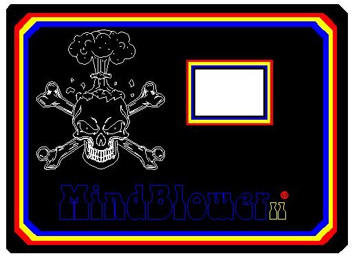

Berzerker Posted October 1, 2020 Author Share Posted October 1, 2020 (edited) It's in both my windows and AutoCad folders. I installed it as a windows font but when I searched for it in AutoCad it wasn't there. So I copied and pasted it to my AutoCad folder and it was there. it worked. Here is all I wanted to see when this whole thing started: I wanted to give it a 70's/Retro kinda look It's a bottom sticker label. While I'm waiting on other things I might as well get all the rest done. I might have to give up my beloved skull...It just don't look or come out right on the label Edited October 1, 2020 by Berzerker Quote Link to comment Share on other sites More sharing options...
Cad64 Posted October 1, 2020 Share Posted October 1, 2020 38 minutes ago, Berzerker said: It's in both my windows and AutoCad folders. I installed it as a windows font but when I searched for it in AutoCad it wasn't there. So I copied and pasted it to my AutoCad folder and it was there. it worked. When you install TTF fonts to the Windows Fonts folder you have to close Autocad and then open it back up in order to see the newly installed font. That sticker definitely looks 70's/retro. Quote Link to comment Share on other sites More sharing options...
Berzerker Posted October 1, 2020 Author Share Posted October 1, 2020 Ooops, I didn't do that. I don't want to mess anything up in the text settings so I'm avoiding messing with the font folder. The skull was just a logo thinking thing after I found the box with the old speakers in it. With the skull: Quote Link to comment Share on other sites More sharing options...
