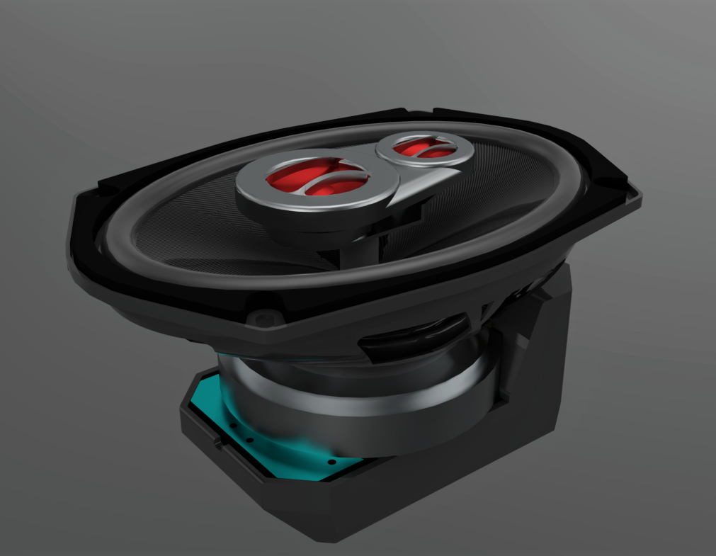

f700es Posted September 25, 2020 Share Posted September 25, 2020 I like it. My 20 year old son is in to speakers and such so I'll show him your work. He made a sub box for a friend of his that doesn't have a lot of money and we used the CNC machine at work to carve in the logos on the top. The kid almost cried when he saw it. Any way here's 5 minutes of work in Simlab Composer Lite (free) with materials and a 2 min 30 sec render. 1 Quote Link to comment Share on other sites More sharing options...

f700es Posted September 25, 2020 Share Posted September 25, 2020 4 minutes ago, Berzerker said: You must read minds! I was just searching for a third party renderers. Yeah they are great. I love AutoCAD and use it everyday but there are better rendering solutions out there. I've seen some GREAT render from AutoCAD as well but I just don't think all the extra effort if worth it imo. Simlab Composer is a great tool. The free 'Lite' version is a great starting point and the 1st tier "pro" version is a great bargain at $199, last year around Christmas they had it on sale for $149. It also comes with integration tools for all the popular CAD programs...including AutoCAD https://www.simlab-soft.com/3d-products/Integration/simlab-composer-AutoCad-integration.aspxhttps://www.simlab-soft.com/3d-products/simlab-composer-trial.aspx Quote Link to comment Share on other sites More sharing options...
Cad64 Posted September 25, 2020 Share Posted September 25, 2020 13 minutes ago, f700es said: here's 5 minutes of work in Simlab Composer Lite (free) with materials and a 2 min 30 sec render. Looks great! I'm always impressed by the renders that come out of this free program. 1 Quote Link to comment Share on other sites More sharing options...

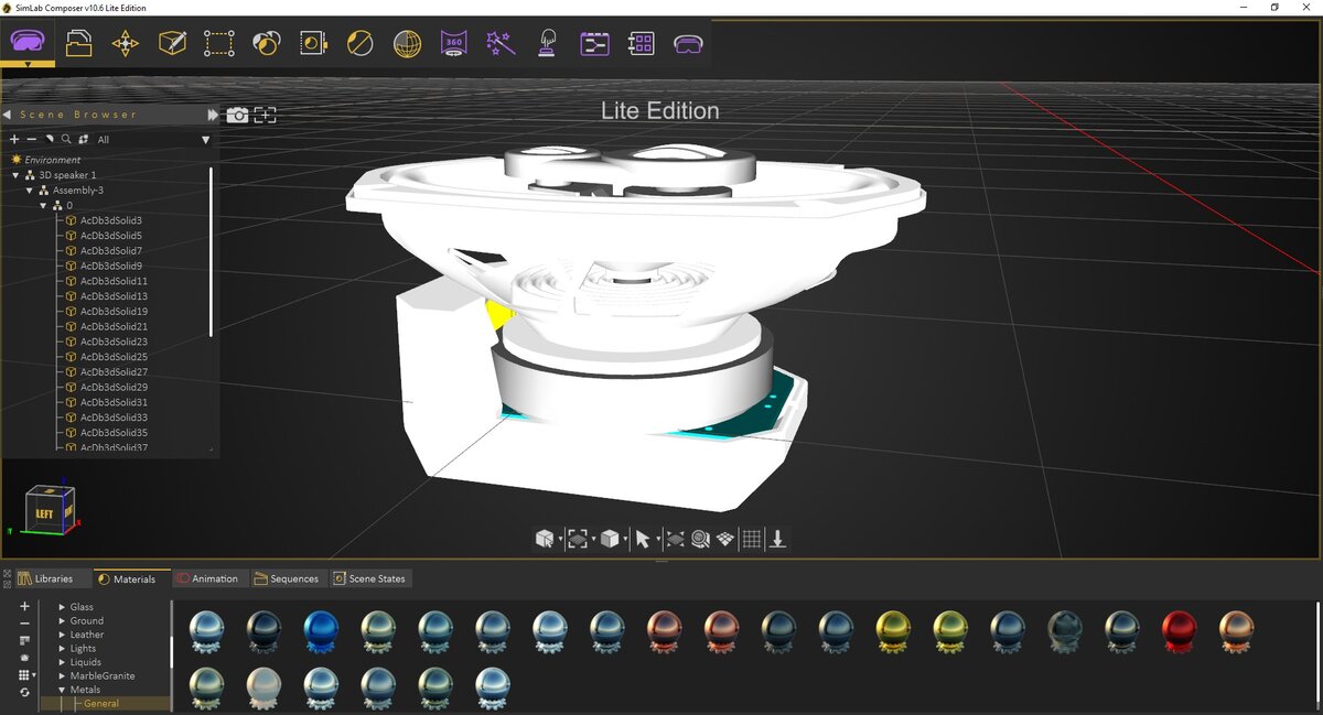

f700es Posted September 25, 2020 Share Posted September 25, 2020 Sorry didn't see you Acad version my bad. Yes, it's a stand a lone program and it can open your cad file. Here's what it looks like with your file in it.... Quote Link to comment Share on other sites More sharing options...
Berzerker Posted September 25, 2020 Author Share Posted September 25, 2020 Yeah it didn't work. Got my layers right finally. I can turn off, on, freeze and thaw, attach materials by layer...etc. I'll look for an older render program. Quote Link to comment Share on other sites More sharing options...
f700es Posted September 25, 2020 Share Posted September 25, 2020 Well you can still use it, you'll just have to break faces in SimLab and apply materials to those faces. Not a deal breaker. Quote Link to comment Share on other sites More sharing options...
