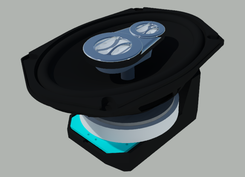

Cad64 Posted September 23, 2020 Posted September 23, 2020 I'm not sure why that's happening? If you want to upload your file, I can take a look at it later and see if I can tell why the chrome isn't working. No guarantee's though. The difference in versions makes it a little difficult for me to diagnose these issues. It will probably work fine if I open it in 2018. Quote
Berzerker Posted September 23, 2020 Author Posted September 23, 2020 The more I think! I'm using chrome satin and I don't know if that's the same thing? I've looked for just chrome but I haven't found it yet. Hope you get it all I didn't close AutoCad before I sent it I just done a quick save and attached it. 3D speaker 1.dwg Quote
Cad64 Posted September 23, 2020 Posted September 23, 2020 Yeah, the satin chrome you're using isn't working. I applied a polished chrome material and rendered and it works fine. I'm not sure why you don't have a polished chrome? That's a pretty standard material in all 3D programs. Quote
Berzerker Posted September 23, 2020 Author Posted September 23, 2020 (edited) I'm just missing something, Don't know what? Looks great if I could do that I'd be in hog heaven. It isn't that important to the working part of it but it would be nice to have where it looks just like it when you render it. I'll fiddle with it here and there and I'll figure it out. Somewhere there is a page that will tell me what exactly I'm doing wrong. Thanks Cad64 for everything. Edited September 23, 2020 by Berzerker Quote
Cad64 Posted September 23, 2020 Posted September 23, 2020 You might have to create your own polished chrome material. Take a look at this thread from the Autodesk forum: https://forums.autodesk.com/t5/autocad-forum/chrome-material/td-p/2535343 Quote

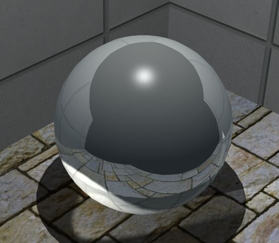

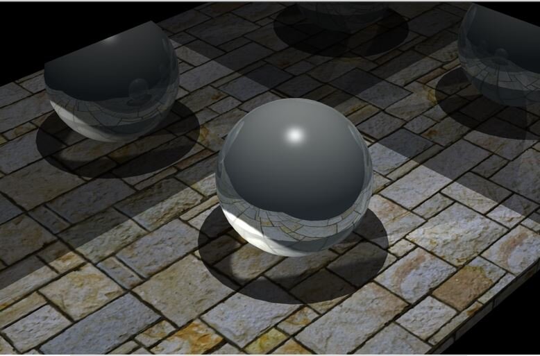

Berzerker Posted September 24, 2020 Author Posted September 24, 2020 (edited) I'm getting close! Here's Chrome: Working on the light part now. With Mirrors: Edited September 24, 2020 by Berzerker Quote
Berzerker Posted September 25, 2020 Author Posted September 25, 2020 I'm beginning to think my speaker drawing is corrupt or something. It won't change/add an object from the materials palette sometimes but if I make one myself it will except it sometimes. Chrome even though I made it in both drawings will work in my marble drawing but not my speaker drawing. I've tried to remove all materials from the drawing but that doesn't seem to work either. Can select certain objects to change but there is one part of the speak it just refuses to allow me to select it to be able to apply a material, it's weird. Quote
