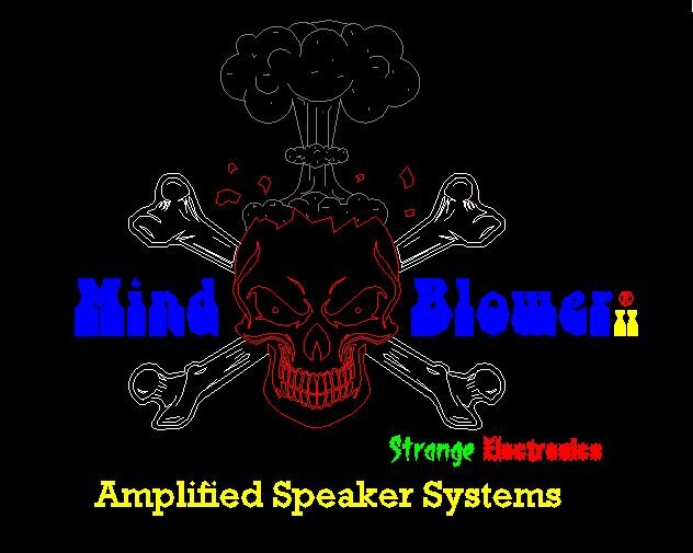

Berzerker Posted September 22, 2020 Author Posted September 22, 2020 (edited) I could change the first two but SKYSTATUS and LIGHTINGUNITS said "unknown command". Turned my screen gray/grey depending on where you live. Opened the sunproperties and yeah, I need to do some more reading. I can't get my logo to look right no matter what I do (?) One way it takes out my cross bones the other way I can't see the skull at all. I made this awhile back and I'm still working on it but when I BMP it out it comes out fussy and looks bad, it doesn't print good/right and it's driving me crazy trying to figure it out. I wish I had a 3D printer boy could I move forward! My friend is still doing his two week thing and I won't be able to tell to print me another one till he gets back. Edited September 22, 2020 by Berzerker Quote

Berzerker Posted September 22, 2020 Author Posted September 22, 2020 (edited) 32 minutes ago, steven-g said: See if there is anything close here https://wiki.hackerspaces.org/Alabama providing they are still running looks to be some old address's there Soon as you posted that I went looking up 3D printer services. I haven't had time to go through them all yet and check out prices and not trying saying anything bad about my friend it might be a better option than trial and error/learning on his part. He hasn't had it that long and "IS" still learning how to print with no errors. But it is free! 13 minutes ago, Cad64 said: Take a look at this link. There's some good information for older versions of Autocad: http://www.dscohn.com/AU/handouts/GD115-2 Rendering part 2-DOC.pdf I'll read this thanks. I found out there is a difference in output types (BMP, PNG, JPEG and TIFF etc. I tried a few of them and seen a big difference right off the bat. Lets see if this looks better on the forum: Nope, wouldn't let me post a TIFF pic. Edited September 22, 2020 by Berzerker Quote
Cad64 Posted September 22, 2020 Posted September 22, 2020 40 minutes ago, Berzerker said: I found out there is a difference in output types (BMP, PNG, JPEG and TIFF etc. I tried a few of them and seen a big difference right off the bat. Yes, Bmp is the worst image format. Tiff is the highest quality, but also the largest file size. Jpg is "Ok" quality and small file size. It's a good file format for posting online. Png is great quality with a reasonable file size. I typically save images to Png format, but for posting on the forum, I save to Jpg format. The reason your Tiff image was rejected is that it probably exceeds the image size limit for the forum. Save to Jpg and you shouldn't have any issues. Quote
Berzerker Posted September 22, 2020 Author Posted September 22, 2020 Bad thing is I had to change it to a BMP to erase the background and make it transparent. Hope it lets me save it back as a raster image later. Using paint shop pro 8. I want to print a sticker to put on the bottom but as I said it doesn't print good as a BMP. I can't use white as the background color of the sticker because the bones are white and they would be invisible when printed. Quote
Cad64 Posted September 22, 2020 Posted September 22, 2020 I don't know anything about paintshop pro, but you might want to take a look at these tutorials for setting up a postscript plotter and then plotting to .eps format, provided paintshop can open .eps files? https://www.cadtutor.net/tutorials/autocad/postscript-plotter.php https://www.cadtutor.net/tutorials/autocad/autocad-to-photoshop.php Quote

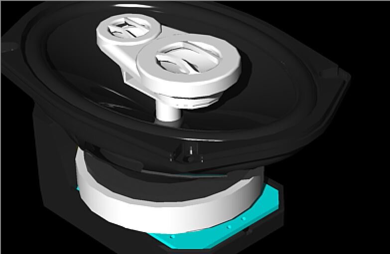

Berzerker Posted September 23, 2020 Author Posted September 23, 2020 (edited) OK I've found two things so far on SKYSTATUS. There is a command "DEFAULTLIGHTING" and it's set to 1 meaning "on" I'm guessing. After reading through the pages Cad64 posted for me and the advanced render settings I only found this: https://knowledge.autodesk.com/support/autocad/learn-explore/caas/CloudHelp/cloudhelp/2015/ENU/AutoCAD-Core/files/GUID-F8A234CB-5742-4660-AC41-09287EC5161B-htm.html In Final Gather it says: Mode Controls the final gathering dynamic settings. On. Turns on the global illumination in final gather. Off. Turns off the calculation of global illumination in final gather. Auto. Indicates that the final gather should be dynamically enabled or disable at render time based on the skylight status. But I can't find where to change skylight status settings.......yet! There is no auto in my Final Gather settings I changed the "DEFAULTLIGHING" to 0 and rendered I got this: Edited September 23, 2020 by Berzerker Quote

Cad64 Posted September 23, 2020 Posted September 23, 2020 The chrome doesn't look like chrome because there is no environment for the material to reflect. So it's reflecting the black background, which makes it look black. Take a look at this link: https://knowledge.autodesk.com/support/autocad/learn-explore/caas/CloudHelp/cloudhelp/2020/ENU/AutoCAD-Core/files/GUID-04F52D0B-AF89-4036-99EC-874B22D0D176-htm.html Quote

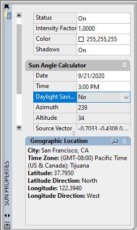

Berzerker Posted September 23, 2020 Author Posted September 23, 2020 I've opened that going through everything this morning. Apparently this is not where this is located in 2007. Here's what I see: Quote
Cad64 Posted September 23, 2020 Posted September 23, 2020 Maybe this link will help: http://www.dscohn.com/AU/handouts/GD111-3 Rendering Part 1-PPT.pdf Sorry I can't be more "hands on" with this but 2007 is very different in terms of how you go about setting up lighting and the rendering environment. Quote
Cad64 Posted September 23, 2020 Posted September 23, 2020 Also, did you change PERSPECTIVE to 1 and SUNSTATUS to 1 before you rendered? If not, do that and then open the Sun Properties dialog. It should look different after changing those settings. Quote

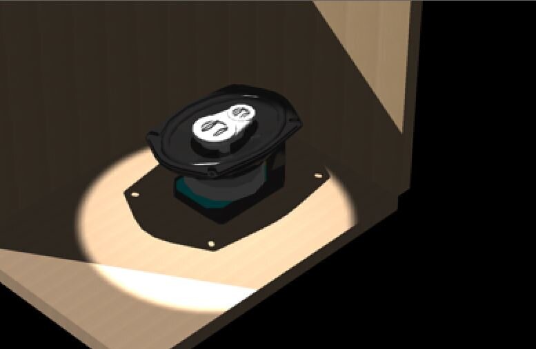

Berzerker Posted September 23, 2020 Author Posted September 23, 2020 Still messing around with it and I added a spot light to it...Still no chrome Quote
