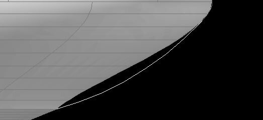

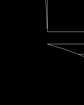

I found a big flaw. I might as well start all over. I called myself checking all this but this one slipped by me. It's only a few thousands but I've tried to separate them with no luck.

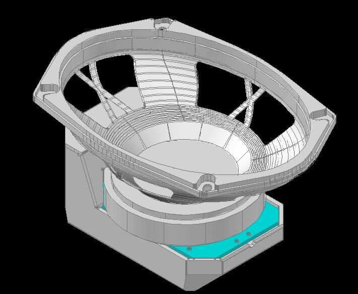

On a good note I found out the cover was not the right size and wouldn't have worked/fit anyways. I guess the scale didn't come out right (?) Made me feel better about breaking the middle piece. The other thing that got me wondering was how far off it was, It was an whole 1/8" smaller than it was suppose to be. It gives the measurements when you load it and I double checked them in AutoCad in millimeters (They were correct on my end). The scale I used was times 25.4 as instructed.
So I'm guessing lofting has its limits?
I've changed every number in the loft settings up and down. I can't get it to make it more round at the bottom or Top no matter what.
I got it better and it's close.

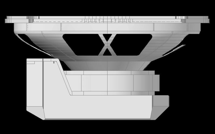

Yeah here's the drawing
3D speaker 1.dwg

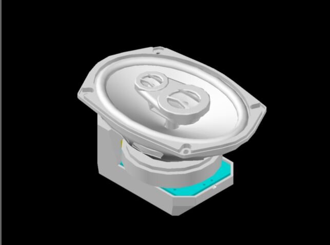

I think I got it pretty  good.
Edited by Berzerker
I only have 3 parts left to go in my 3D speaker and I found another flaw. I'm debating if it is enough to redo that section,
if it was me, I would fix it. But I'm kind of a perfectionist. ;)
I finally think I got it done. Haven't added any materials "fixing to read up on that", Is it to the thousands "Probably not". I used two scales and a set of calipers. The magnet itself measured something like .725 I just made it .750 as an example but the overall dimensions are very close. Could you buy this speaker and use it as a template....."I think so!".
It's hard to measure an oval when you don't have the tools to measure it right. The metal outside of the speaker was .045 thick so even if I set my measurements at 1mm wouldn't have been correct. I seen something this morning about setting the wall thickness of an object but it's a little late now.

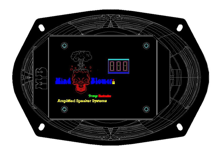

I wanted to see what my logo looked like on the bottom. I wish I could get close to this color when I have a black background. Can't make silverish/gray color and I haven't found chrome yet, well at least the chrome I've found don't look like chrome. Looks more black than anything!
Looks better in AutoCad.

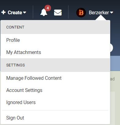

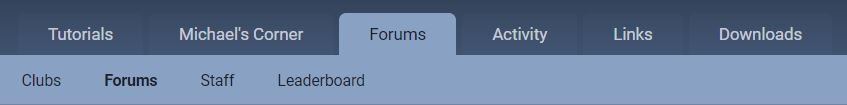

What happened to the "online users" at the top? I liked being able to see who was looking at what.
Yes, chrome will look black until you set up your environment and render.
When you get ready to render, you will need to change some settings.
Set PERSPECTIVE to 1
Set SUNSTATUS to 1
Set SKYSTATUS to 1
Set LIGHTINGUNITS to 1
The "Online Users" is still there. Not sure why you can't see it?

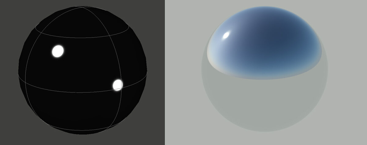

Here's the same sphere, with the polished chrome material applied.
The image on the left is what you see in the viewport. The image on the right is what you see when you render.
Thanks Cad64 for the render settings. I see "staff" instead of "online users"
That's strange. I still see "online users", so it hasn't disappeared. Are you using a different browser?

I tried to open it from a new window to see if that was the cause but it wasn't. I've been using MS Edge for about a year so it can't be that. The only things I do are post, read and look to see who's looking at what. The only other thing I've done is change my avatar. I'll look into it today.

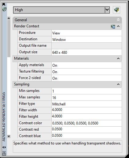

Edit: I found the render settings but I don't see the ones you listed.
And here's what I see now at the top of the page
Edited by Berzerker
You need to be signed in before you see that option
I thought I was signed in?
Signed out then back in still no change.
Edited by Berzerker
You need to type these at the command line and change the settings.
Set SUNSTATUS to 1
Set SKYSTATUS to 1
Once you change the settings, you can open the SUNPROPERTIES dialog and make adjustments to your lighting.
But again, I'm using 2018 and you're using 2007, so some things may be different for me than they are for you. You should look for tutorials on materials, lighting and rendering in 2007.
