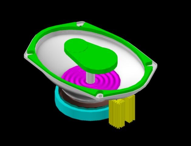

I'm starting to like the results. But I have to fix the colors and I'm working on it. I hate a white background but I guess I'll have to use it when I do the final render.
I'm working on the midrange and the tweeter now. Just thought I'd give an update and let you all know.
It's looking pretty good. You've come a long way since your first post. :thumbsup:
For the final render, you don't have to use a white background. In fact, I would advise against it. I would create a large box under the model to use as a sort of tabletop. Then you can apply whatever material or color you want to the box. The box will also receive shadows which will help to ground the model, so it won't look like it's just floating in space.
Thanks Cad64. I wouldn't have thought of that. I'm finding it hard in my materials list to find a dull silver like plastic color. The speaker itself is black metal and on my final render I want the colors to be just like the speaker looks. chrome-ish color is not there either but reading on the subject I just need to find something close and tweak it.
The reason I have it all kinds of colors now is so I can keep things separated in "MY" head. I've done enough deleting only to say whoops too many times.
Yeah, I don't remember what materials were available in 2007. That was too long ago. I'm surprised that you're not finding a chrome material though. I would think that would be standard. The plastic should be easy to tweak. Just pick one and adjust the RGB value until it looks right.

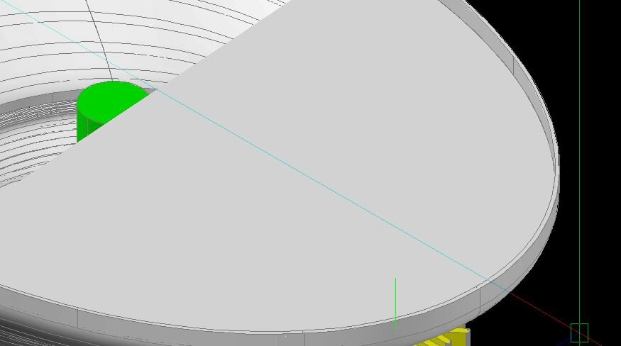

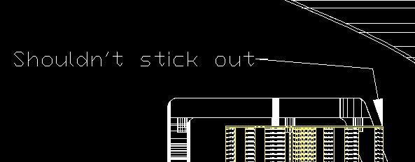

I knew I was right. In my 2D drawing it is no where near like this. It shows it fully enclosed inside my cover in 2D but as you see I goofed again.

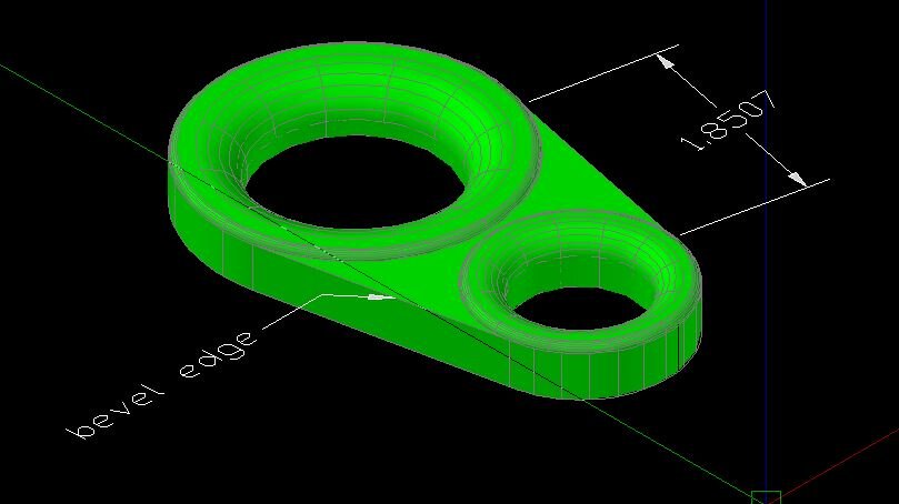

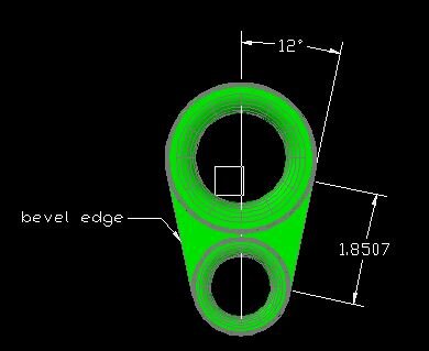

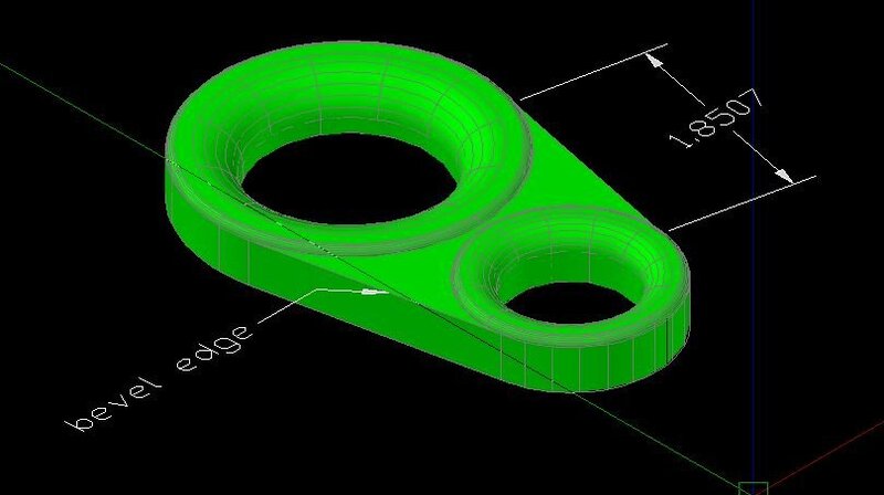

I'm having a problem trying to get this right. I need to bevel an edge and I can't get it to rotate to the right position. When I use angular dim it only tells me 12 degrees. I have my units set to 3 decimals, Dim to 3 decimals but it only shows the 12 degrees nothing after it. I want to rotate the object so the side is perpendicular to up and down, taper it and then rotate it back to the normal position afterwards.

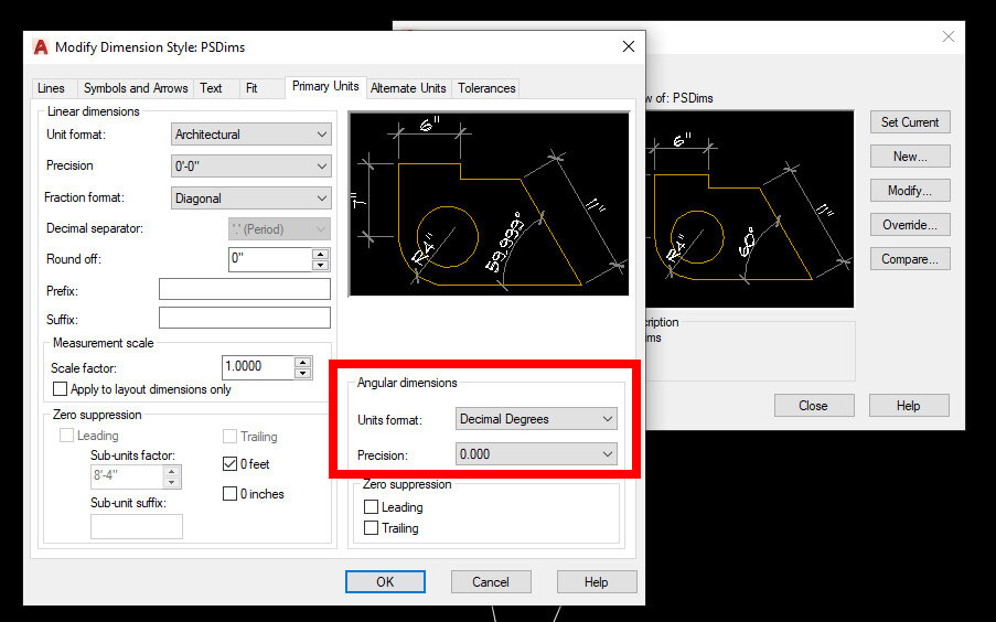

In your dimension style, you need to also set the Angular Dimensions precision.
perfect! I'm learning so many things as I dive into 3D. I always thought when you start drawing in 2D in AutoCad it was like drawing on a flat piece of paper "This is not the case".
If you switch to an ISO view a line could be inches away from the other object that you just drew or you tell it to place it at a quadrant and you look at it in an ISO view it's no where near you told it to be.
Thanks Cad64

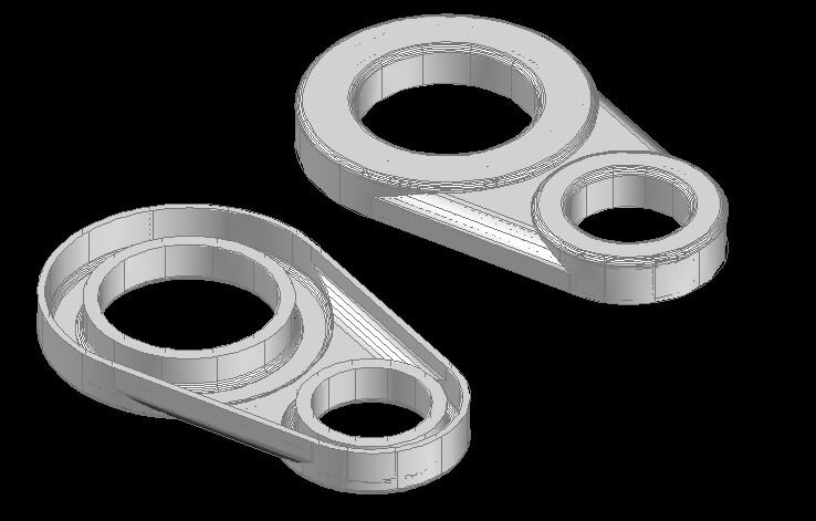

Ever had one of those days? Like God is testing your patience. After Cad64 helped me get my angular setting right everything was going great. I rotated my object to the right position and start trying to put the bevel on it. I made my beveling shape, extruded it and when I hit subtract everything disappeared (the whole object). I look down and read something in the command line about a "Null solid". So as I stated before I come here I go to the internet and looked up what a null solid is (?) I was told by google that it's when there isn't enough material/object left over so it can't perform the command (?) I know better than that! The object is 2.5" round at the top and 4.187" long (Object two posts up) and all I wanted was to place a bevel on it. So I come back on here to ask if there is some other reason why it would do this and my internet is down. So while I waiting for it to come back up I keep fiddling with it and made another one from scratch and didn't union them first and then tried to place my bevel on it, It worked. Then while trying to hollow out the bottom my snap just stopped! No matter what UCS I used or what view I was in "no snap" and I checked everything snap was on. so I saved, shut down and restarted AutoCad. pull the drawing back up and it's fine, snap is back. Only to find that now there is a part I was using to subtract with now union-ed with my part. I tried the solidedit command to try to separate them with no luck. And with my internet down I have no Google or you all to come and ask! Now you have to realize this has been an "ALL DAY" thing trying to make this one piece. All of a sudden I get a call from my buddy and he's going to bring over my cover. He shows up, we shoot the bull for about 20 minutes and I come inside to check them out "Finally something is going my way". The parts were a little stringy so I was cleaning and seeing if they mated together right when.......SNAP! I broke the middle piece.

After 2 days I'm close. I don't like the color but I'm learning how to edit materials.
The parts look great. Too bad the actual printed part broke. But, that's all part of R&D. If at first you don't succeed. Try, try again.
