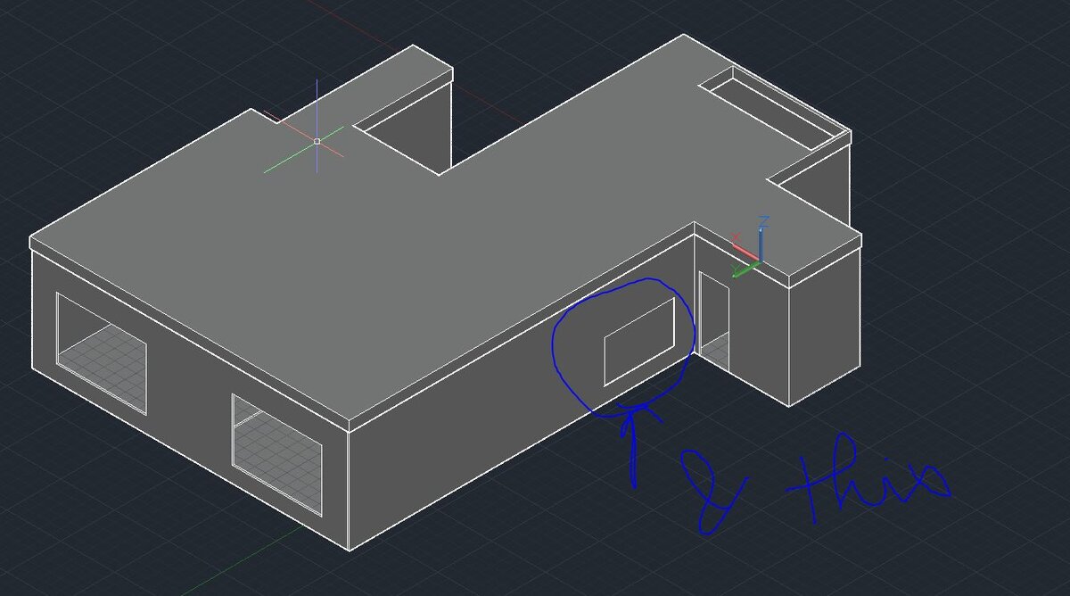

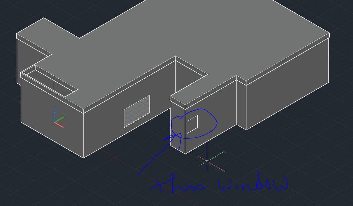

Kindly need your support to know how to fix this without restarting from scratch to extrude the windows from the dwg file and screenshots marked with where I am having challenges.
The cause of this in my opinion is I exploded the surface back and I wanted to add two windows but for some reason the two surfaces no matter what I do they are not connected.
Please let me know how to fix this, keeping in mind I am an amateur who did not study or know autocad, I just want to design my 2- story apartment to be able to do my interior design afterwards.

Well your wall is an exploded solid and now a region. Your window is a 3d solid. I think that you might have to restart your walls and leave them as 3D solids. Sorry but I am not sure of a "good" way to fix it. I never explode my solids. Good luck
Sean
I probably would have left them as 3D Solids then used PRESSPULL to add the windows quite easily.

I know both of you are correct because I learned the hard way :D, as I am still a beginner getting to know the mistakes now.. but do you know of a way to turn them to 3d solids without restarting the walls?
You can 'trim" surfaces but I'd rather work with solids :(

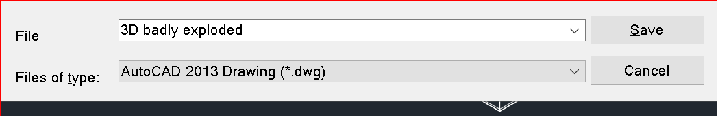

If you want to post a .DWG to the forum you might want to save it as an older file type.  As I use Autocad 2016, drawings which are saved as
later than 2013 are problematic.  Use the file type definition dropdown menu to specify how you want it saved, as in the screenshot.
This will help us to help you.

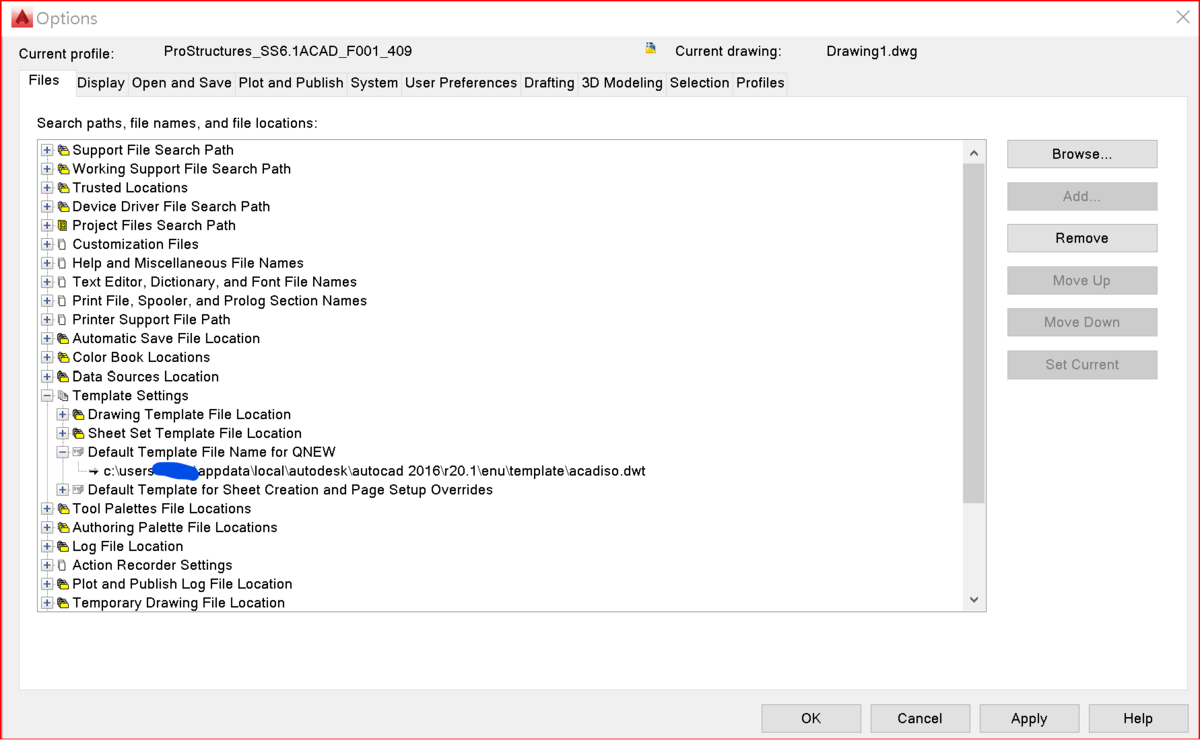

Should you be in a Metric friendly zipcode you will likely want to change your DEFAULT QNEW DRAWING TEMPLATE from the current default.
Right click inside the COMMANDLINE and choose Options from the bottom of the list, then just follow the screenshot.
When you are ready to exit that dialog click OK.
Having done that, the next time you start a new drawing in Autocad, it will use the ISO template which you have just specified.
Using that template, as is, your drawing units will be set to mms, meaning that if you draw a line and specify the length as 1000, it will be 1000 mms long, AKA one metre.
