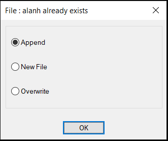

BIGAL Posted September 3, 2020 Share Posted September 3, 2020 Thought that is interesting how to do exists in multi radio buttons. (if (not AH:Butts)(load "Multi Radio buttons.lsp")) (if (not but)(setq but 1)) (setq ans (ah:butts but "V" (list (strcat "File : " cfile " already exists") "Append" "New File" "Overwrite") )) Quote Link to comment Share on other sites More sharing options...
