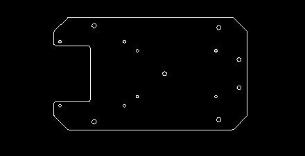

Berzerker Posted August 21, 2020 Posted August 21, 2020 Don't know if anyone here has worked in this field but I guess it won't hurt to ask. I'm wondering is it better to use a punch press or a CNC milling machine to make repetitious parts? I need to punch holes in an 1/8" aluminum plate ranging from 5/64" (.078), 9/64" (.140), and 1/4" (.250). These will be tapped all but the 1/4" hole it's a line up hole. If I ever get going there will be hundreds if not thousands of these. Can you punch a hole in a 1/8" plate with a 5/64" or 9/64" punch or do you think it will break? A milling Machine costs thousands and to tool up a press would be about the same. I think the press would be faster just slide a part in a press the buttons and in about 1 to 2 seconds a part comes out all but tapped. Milling machine one hole at a time. Quote
Berzerker Posted August 21, 2020 Author Posted August 21, 2020 (edited) I was thinking about an in house type of thing. I guess I could just send out specs and see what comes back. A piece of 4' X 8' sheet is about $230 and a piece of 1/8" X 3 1/2" X 6" long is about $3.10 per piece. If I'm doing my calculations right a 4' X 8' would get about 195 pieces but I don't know how much (yet) for the laser cutting per piece. If I do it myself once you pay do don't have to come out of pocket for a little while. Edit: I guess I just answered my own question $3.10 X 195 is about $605 Edited August 21, 2020 by Berzerker Quote
SLW210 Posted August 24, 2020 Posted August 24, 2020 I would suggest a waterjet. You will not be able to punch holes smaller than the thickness, plus, punched holes are tapered, not optimal for threading. Laser holes are not great for tapping either, I found they needed to be small enough to drill out some material before tapping as the metal on the edges were too hard to just tap or even ream. You might try pricing pieces already to size and drilling/tapping on a drill press versus having a full sheet cut and processed. Quote

ammobake Posted August 24, 2020 Posted August 24, 2020 a plasma cutter table would also work. Send it a DXF and it will do all the work for you. I wouldn't recommend a CNC for sheet metal type work, specifically. There are autocad add-ons that will create layout for a specific part to maximize your yielded parts per sheet. I worked for a sheet metal company back in 2005 and probably spent half my time creating layouts and sending DXF cutouts to the plasma cutter - mostly for ductwork. But occasionally got to work on some unique jobs. -ChriS Quote
Berzerker Posted August 24, 2020 Author Posted August 24, 2020 (edited) @ammobake Believe it or not I got an email from one of the people I contacted about the plasma cutting.....You won't believe what I got back. Quote We do have a plasma table that we could have some material cut for you but the rule of thumb is to not cut a hole smaller than the thickness of the plate. For example on a 1/2" plate, I could not cut anything smaller than a 1/2" dia. hole. If you can give me some more specifics I will let you know what we can and cannot do. Thank you, Expand So is this guy telling me if I wanted to cut a piece of metal 1 1/2" thick I couldn't put less than a 1 1/2" hole in it . That's the dumbest thing I ever heard. You just tell it what size hole to put in it point and hit start. The plasma doesn't know it's not suppose to put a certain size hole in a certain size piece of metal or plate. I mean the person controlling it tells it what to do not the other way around. Edited August 24, 2020 by Berzerker Quote

ammobake Posted August 24, 2020 Posted August 24, 2020 Per plasma cutter - If the hole diameter is smaller than the material thickness it can end up distorted. It is possible that you can end up with holes that are rounded over or not square but there are a variety of factors that can be "tweaked" to a degree to improve quality of the cuts. I believe in your case you were wanting to cut 1/8" stock. It's possible that at slow speed you could end up with a good cut at 5/64 diameter with 1/8" thick material but it would take trial and error. And when it's just easier to design the product with hole diameters 1/8 and up to avoid those issues - that would make more sense in my view. As far as sourcing fabrication for this kind of thing, i have no idea what the cost comparison would be between water jet or plasma. But from what I've seen plasma cutters are more commonplace for sheet metal/plate which gives u more options for pricing. -ChriS Quote
BIGAL Posted August 24, 2020 Posted August 24, 2020 Good idea the water jet it may be best with aluminimum. It also can cut all sorts of material like vinyl. Quote
Berzerker Posted August 24, 2020 Author Posted August 24, 2020 @ammobake I can not change the size of the holes on the PCB's They take a #3 screw, I just went with the lesser threads #3-48. I have been thinking to just buy the 1/8" X 3 1/2" bar because it's only the prototype anyways. All I'll have to do is drill and tap the holes by hand. I could just print the hole layout with small dots in the middle of the holes and tape it to it and center punch them. Then I could cut all the out side with a saw I have in my shed. It won't be real pretty but I use to be pretty good at stuff like that but I haven't done it in years. @BIGAL I called the waterjet people in my area this morning so far they haven't emailed me back with a quote. All it does is it's glued on the bottom of the speaker to hold all the components and the cover protects it. Quote
BIGAL Posted August 24, 2020 Posted August 24, 2020 If lasered or plasma just get as you say a centre punch hole then drill at home. If you want lots of them. Then nice clean hole. Quote
